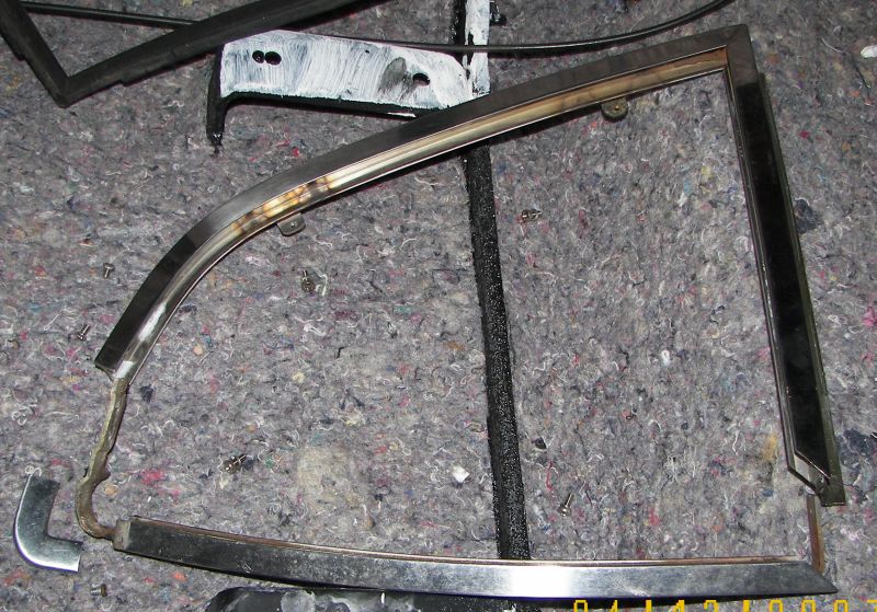

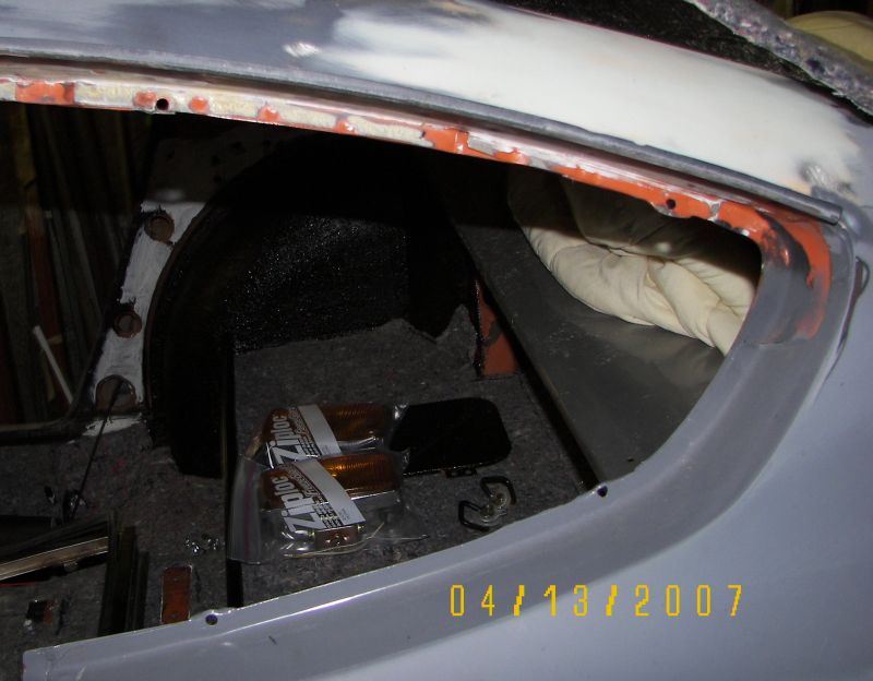

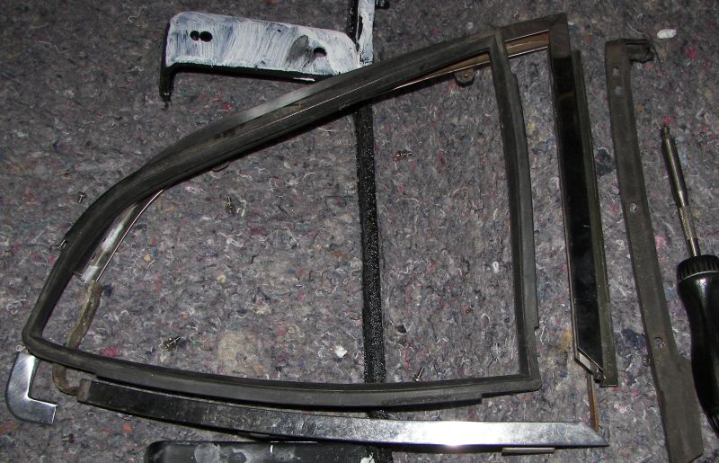

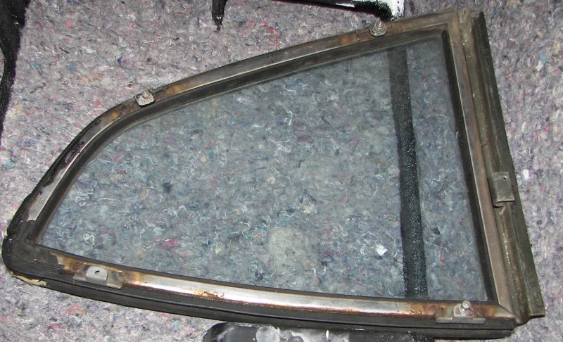

Here is a basic set of pictures,
There are four phillips screws holding the frame together-two panhead and two flats.
The glass simply slides into the frame seal-no sealant needed.
Sealant/adhesive is used to glue the outer seals on to the frame-I can photograph those if you need it-I can take one of the ones I restored apart and lay it out as put together, if these don't get it!
I never knew it would be so hard to take a picture of screws!!!
In the third picture I laid out the screws in the approximate position they go in around the frame-it is a little hard to see, and I appologize.
Will

Thanks SO much for posting these pics...I see what I was missing, my problem is two fold. I didn't realize there were two screws under the seal in the back corner and the screws are frozen in the frame from water corrosion. I'm gonna have to put some Liquid Wrench on the screws to loosen them up. I'm about to head over to the tinter to finalize the estimate and get the hatch window done. I'll be contacting you on the screw set, you have enough for both sides? Thanks again man...
