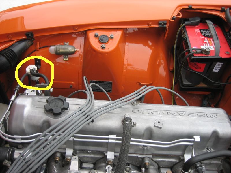

I don't know if this is the right forum to ask this question. I'm trying to
find out where the fuel filter is located on a 72 240z. I tried searching for
it with no luck.
The factory put it on the right side inner fender, as marked in the attached picture in yellow. But yours may have been moved or removed by a prior owner.
yah, the problem was that the old fuel pump went bad and was replaced
with a electric one so i didn't know where the fuel filter went. Thanks .
There should still be one where Bryan outlined. there should also be one between the electric pump and the tank. Back on the passenger side between he rear axles and the tank. There are also small, vary fine screens where the gas enters the top of the carbs float chambers. That is if someone haven't removed them . Gary
