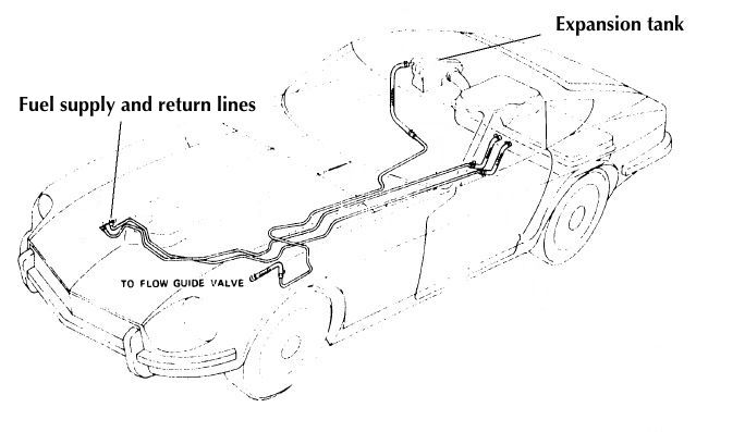

Thanks every1. I got it fig'd now. I uncapped the drivers side 1 & I'm gonna route it into the top of a vented catch bottle I have the valve cover hooked up to. As far as the other 1, I'll be getting another 2way banjo & hooking that up. Where is the stock expansion tank located? Up near the filler or do 71s not have em?
Inside the car, under the right rear quarter trim panel. Just above and in front of the filler.
