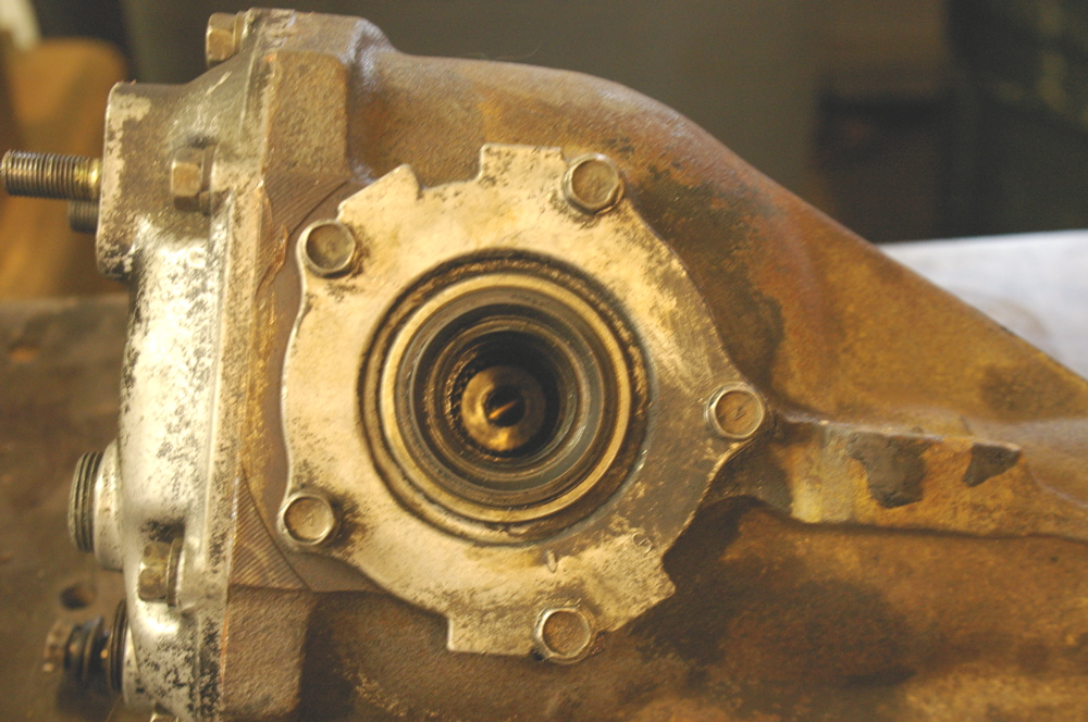

In addition to the cover gasket there are several leak sources on the differential. There are oils seals on each side where the halfshafts enter the housing. There are rubber o-rings on the side bearing retainers that could leak.There is an oil seal at the front of the housing (pinion seal) behind the drive shaft companion flange. The drain and fill plugs could leak if they aren't tight enough. Oil can leak out the vent at the top if its installed wrong or if the diff is overfilled.

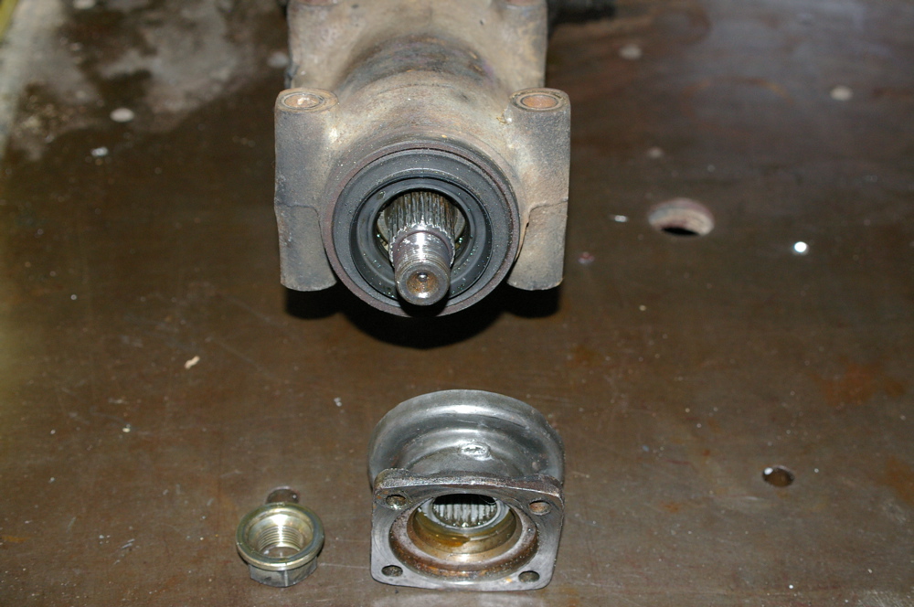

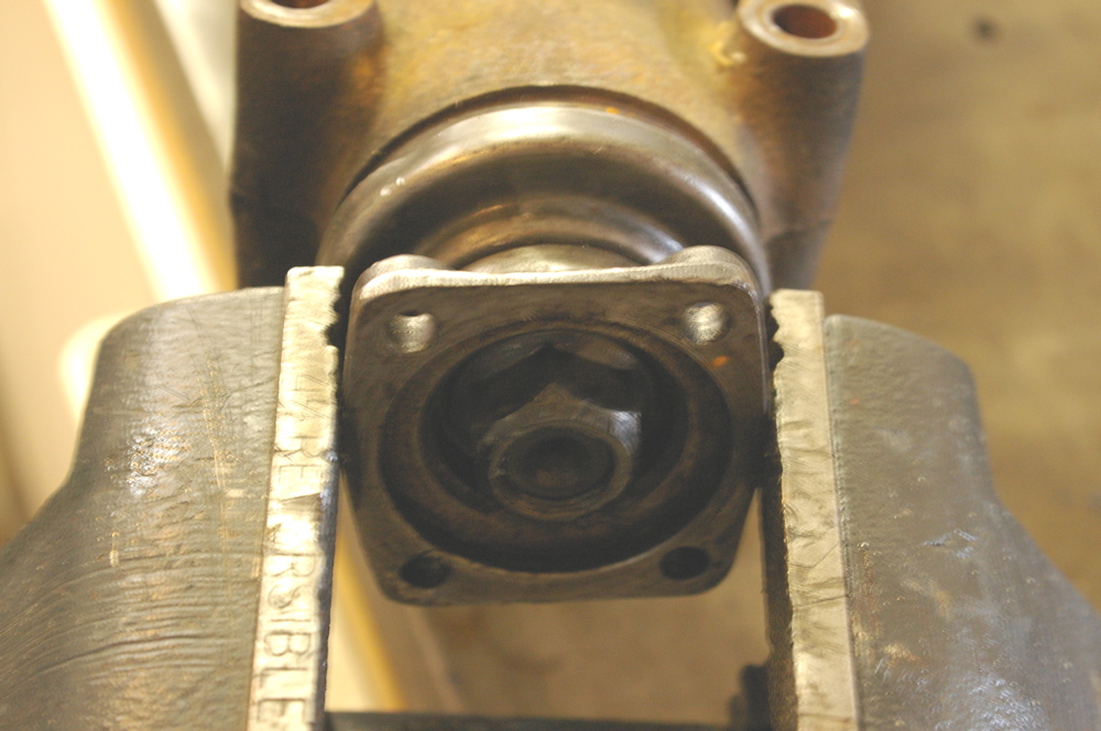

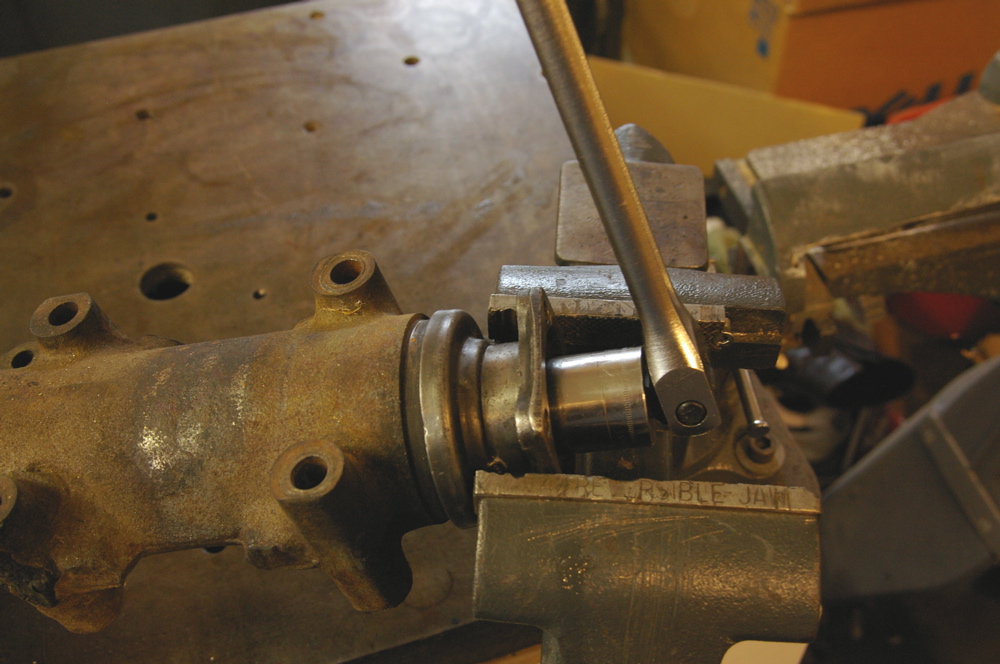

The side seals and the rear cover gasket can be done relatively easily with small hand tools. The pinion seal in the snout is a bit more difficult. You'll need a 27mm socket and breaker bar or an impact wrench to remove the nut on the pinion shaft, it's torqued to 120-140 ft lbs. Once you get the nut off you may have to use a puller to remove the companion flange.
I put the diff on my bench with the companion flange in a vise and used a breaker bar to break the nut loose.
The old seals pry out of their locations fairly easily with a screwdriver. The new seals are tapped in with a hammer. I used the old seals placed over the new seals when tapping them in to protect them from the hammer.
