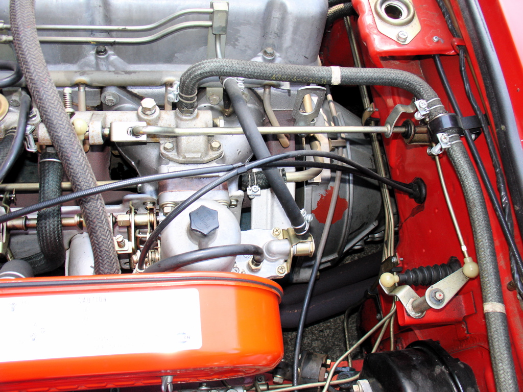

I don't know the difference between early and late grommets, and don't know which style mine might be.
Cables are side-by-side.
Grommet faces upwards.
As shown in the attached picture, the long cable is closest to the engine.
Hope this helps!
I believe I now know the difference between early and late grommets. The late grommet (the one you always see offered these days) has a round protrusion into the engine compartment. The early grommet has two smaller protrusions. In the attached pictures, the early is shown installed in the (red) firewall, and the late is shown sitting on a table.
