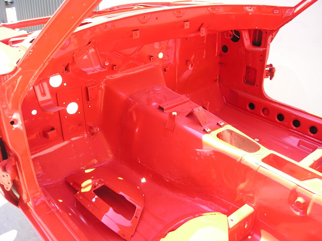

She is looking beautiful by the way, I really cannot wait to see how she turns out, as I'm sure we all feel!
Thanks, We have moved the pick up date back to March. My choice, don't need to bring it home in the middle of the winter in Indiana. Hope to make 2012 Z Con.
I just received photos of all of the parts back from powder coat and we are deciding on tires, possible slight lowering and possible change of wheels from the original 14" Libres to a set of 15" LeMans to open up more tire choices. jlp

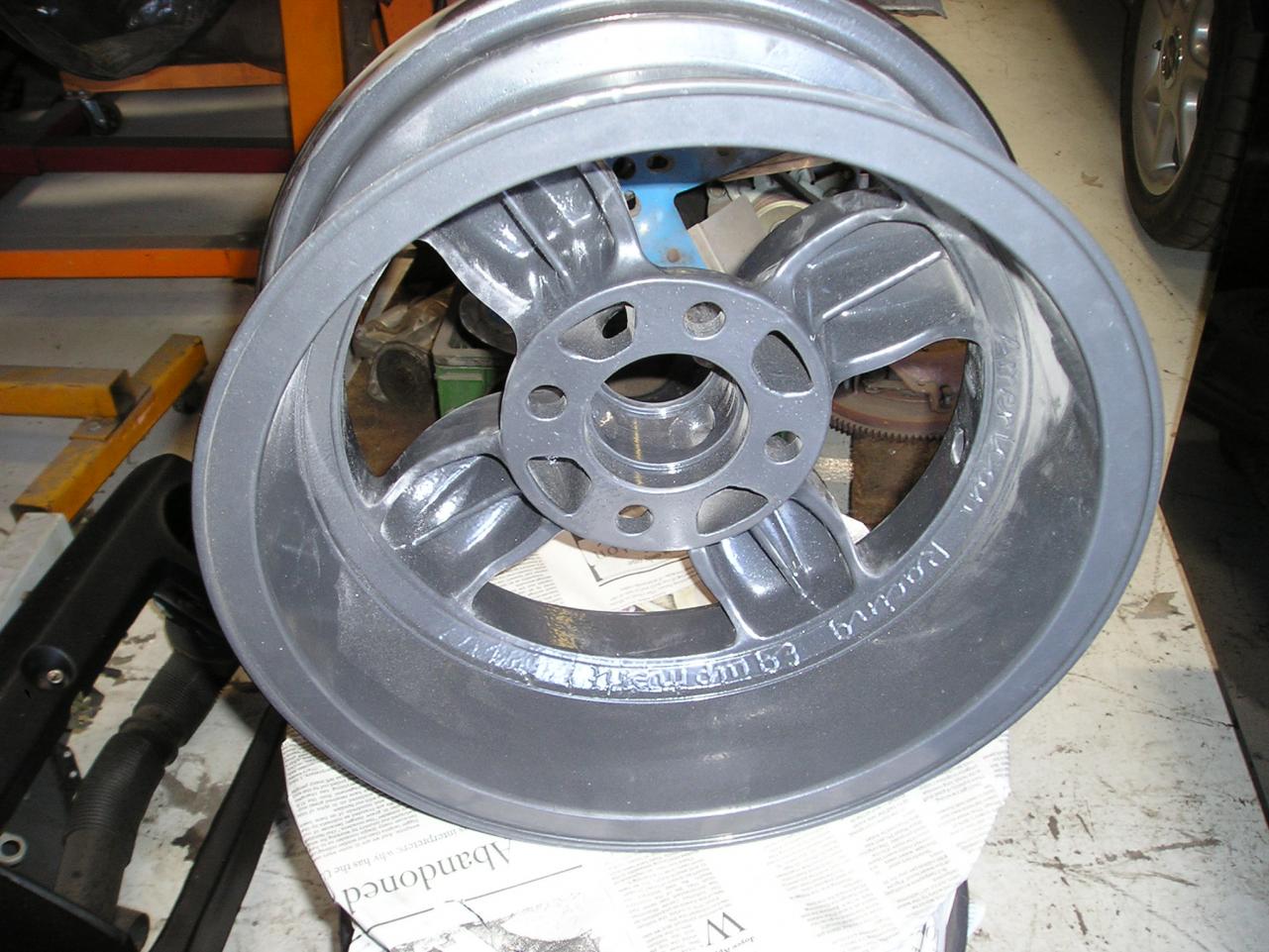

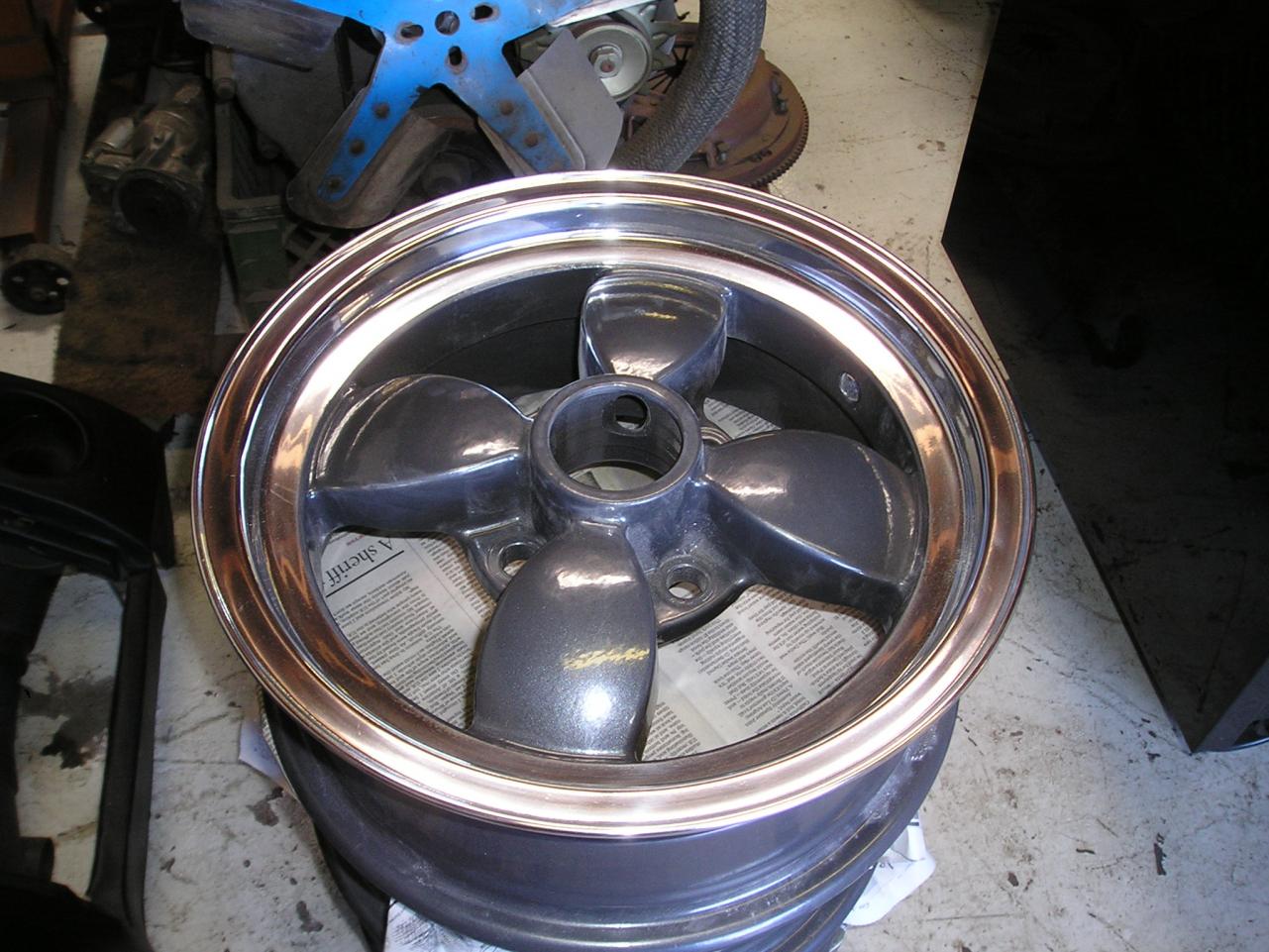

We have decided to stick with the 14"X5.5" AR Libres. They have been restored, I have attached photos. We also decided to stay with the stock ride height.

First, may I suggest that you have the mounting face on the back of the wheels stripped, machined or sanded to bare metal? Having that mating surface painted or coated can lead to lug nuts not staying tight.
Now - tires. We've got 14x5.5 wheels and stock ride height. That means you will need a tire close to stock diameter to not look stupid on the car (too much fender gap). Ideally, I'd say you want a 195/70-14 like I ran on my car. However, there isn't anything left in that size that has any performance capability by today's standards. They are pretty much all mini-van fodder. Then again, today's mini-van tires are probably much better than the typical 175HR14 of the early '70s.
So if you are OK with just normal tires, pick your favorite brand that has something available in 195/70-14 and go with it. I was running Toyo Eclipse on mine, because the tread design was much more conservative looking. Not really vintage look, but not today's wild directional stuff either. But I've heard that Toyo does not distribute the Eclipse line in all parts of the country, so YMMV.
If you are looking for something with some grip, but still tall enough to fill the fender gap as much as possible, there aren't many choices. If you aren't going to be driving the car much, you could try Hoosier Speedsters in 185/70-14 or 205/65-14. Either will fit the 5.5" rim. Hoosier recommends against street use, even though they are DOT marked. But if you look through the Sport Compact mags, lots of kids run DOT-R tires on the street all the time. So I doubt you'd have any serious issues with that. Just don't tell Hoosier...
