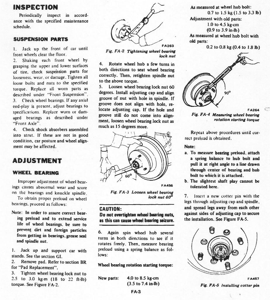

By comparison to the Haynes notes the FSM Datsun 260Z also advises or differs by saying :
1. Jack up the car first and place on jack stands
2. That the nut should be tightened to between 2.5 and 3.0 kg/m (18-22 ft/lb) torque.
3. Advises rotating the wheel hub a few turns in both directions to seat the wheel bearing correctly before retightening the spindle nut.
4. The hole and nut may be loosened out from 60 to as much as 75 degrees total to allow alignment.
5. It then recommends again spinning the bub in both directions to see if it rotates freely before measuring bearing preload using a spring balance.... procedure described
More notes follow in both references but I think this sorts your immediate problem. The Factory Service Manual or the Hatnes manuals are among a number of good references to have on hand for moments such as this.
Tighten the nut up until it's touching the assembly, then back it off a very little bit (like 1/4 of a turn) until the rotor spins freely, but does not wobble if you pull on it.
The FSM and How to Rebuild Your Datsun book also indicates that there should only be approximately 1 lb of force required to turn the hub. You can measure this by attaching a spring scale (like a fish scale) to one of the studs and pulling on it until the rotor spins. The force required to spin the rotor should be approximately 1 lb.
