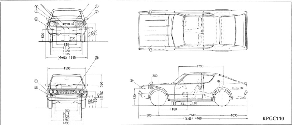

In Japan, the GT-R also came with 175HR-14 so that doesn't really help - but the Sports Option lists offered an 8j magnesium wheel option, which might help your case if you could back it up with hard evidence?
How about the track of the GT-R - would that be any use? Factory data shows the rear track width ( wheel centre line to wheel centre line ) as 1375mm. I believe this was slightly wider than the other models, although I don't see any track data in the UK market factory manual.
Only other thought that came to mind was the extra overall width of the GT-R with its overfenders, quoted as 1695mm. Don't know if that would help you...... ?

i can have a look in the parts manuals etc. i have to see if it lists the GT-R track width.. i did read it somewhere too..
thanks Jim!
perfect!!
where did you find it?
