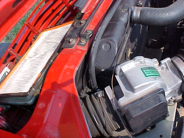

Poor mans cold air intake, I took the top off the airbox and left the sides so I could screw the filter down.

The inside of the intake tube isn't axactly smooth. Smooth is supposed to be better for airflow. Do you think you could line the rubber bellows tube with something like one of those metal heater tubes, but 3" diameter?
then get an aluminum or stainless liner. Or maybe plastic even.
Put the airbox back together! You must have had too much time on your hands when you came up with that one. What do you expect to gain with that setup? If you want a cold air intake, I would suggest buying one. That one makes a nice scoop for water when you're washing the car. Like zguitar said, don't drive in the rain. Out.

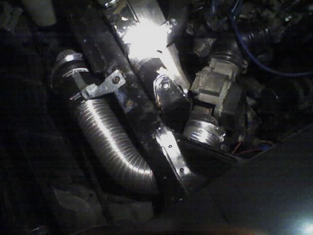

Here is a hint put it back on or you will end up in trouble. LOL Nice thought was there any reasoning with that? I have quick air filter fix for ya.
1 Go and buy the front cone section of a K&N type of filter.
2 Buy 3 large hose clamps about 3".
3 Now go to home depot and find the pluming section. Get a 3" rubber boot about 3 to 4" long.
4 Now while at home depot get your self a nice dryer hose. Preferably you should get the metal type of hose and flexible.
5 You have to remove your current cold air intake. :(
6 Place the new air filter on the rubber boot and clamp with #1 clamp.
7 Place flex hose on other opening and clamp with #2 clamp.
8 Run flex hose through opening toward air flow meter and attach to air flow meter with #3 clamp.
Now you have a cold air intake that works like it should.
P.S. Don't forget to tie up the cone section so it does not fall off. Suggest a home made bracket or even a nice shoe lace (Chrome plated of course) :P
At least you got the smooth hose in there. How strong are the dryer hoses? Can you get it in 3inch, or is that what the short rubber is for (adapter)?

Correct you use the rubber adapter to fit the dryer hose. It is usally 4 " and has to be fitted to fit. Its not jiggly at all. You only use about a 1 1/2 ft of the hose. When the hose is colapsed it is pretty sturdy. My was there when I bought the car and have never changed it and all is fine. Just make a bracket for the air filter..

Got a pictured of that? It sounds like the stuff I have (elbow & filter). Don't forget to make a bracket to support the filter.
