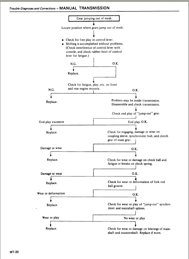

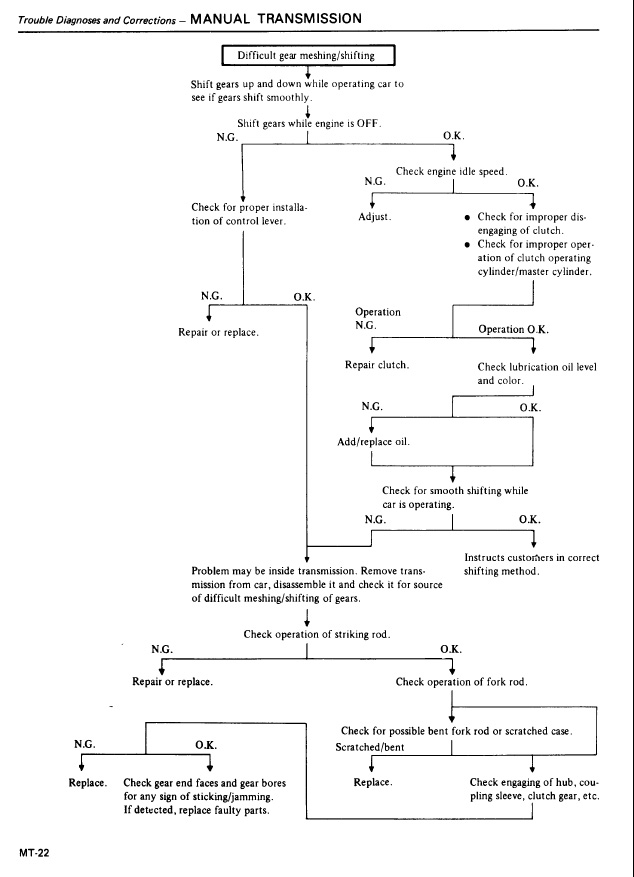

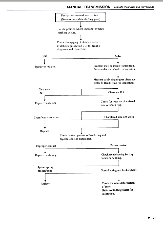

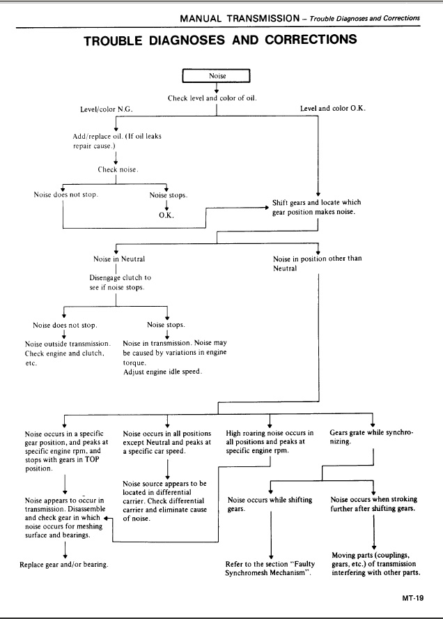

Does it happen only in one gear(wind out the lower on to see if it still happens, or under drive the next one up for the same reason) if it one gear, pretty obvious as to the cause, if in each of the three, still not too hard to figure.
Here is some help...
