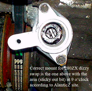

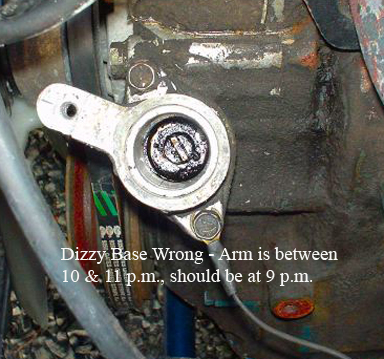

I've gotten some help, but still looking for the part I posted. I think there has been some confusion in exactly what it looks like so I'm posting a couple more photos with text. The problem may be the block I started with, although an F54 was pretty bare and didn't have the mount. I will try looking through the wreckers, but most of them went on a crushing spree recently and I don't think many Zs or ZXs survived. Here's the photos of the part I need if I'm reading the AtlanticZ tech article correctly:
the part you need looks vary much like the 240 piece that the old dist used. I had one but recently gave it to a friend sorry. The difference between the 240 part and the ZX is the place where the dist bolts to. It is in a different location so the dist is turned and wont allow you to properly set the timing . This is for anyone reading this to know the reason . Gary
