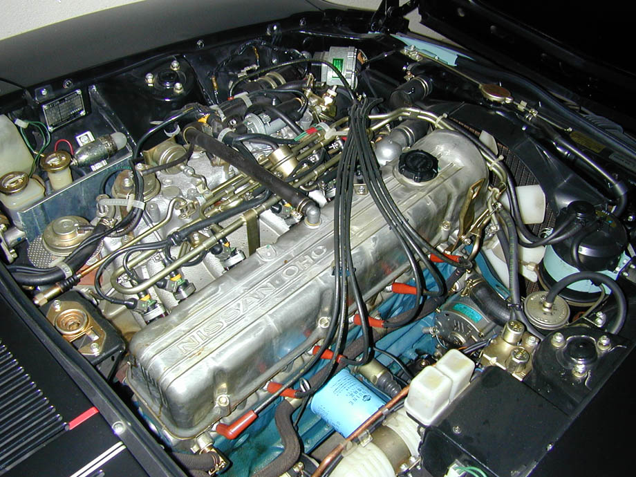

The Fuel Rail was changed 8/77. So the 78 280Z's have the newer type. The picture below is a 78 Black Pearl with 643 miles on it.
FWIW.
Carl B.
FWIW.
Carl B.
Yep, I already found that out Carl :D
I went on ebay for the hell of it and looked at 1978 280Zs for sale with engine bay photos because it's been a long time since I've been under the hood of a '78 and stephen, your right and I'm wrong. every 1978 I found looked just like your fuel set up. Very interesting LOL LOL I could have sworn they were identical to the 75-77's. My stupid error :stupid: ROFL
Sorry - I guess I didn't refresh my screen... took me a few minutes to find the engine photo, resize it and up load it ... and I didn't see your last Post..
Nonetheless.. it's a great picture of Pure Stock and 100% Original...

That Black Pearl edition is amazing. How could anyone let that beauty sit and not enjoy driving it :surprised
Anyways, thanks for the photo.
