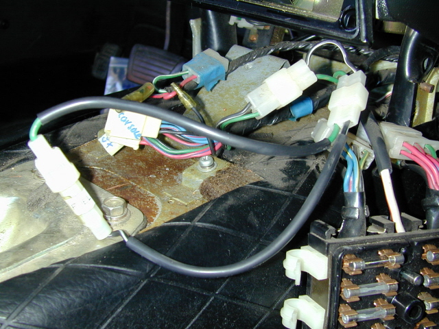

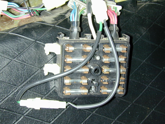

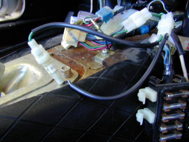

I was visiting NWCubsman to help him remove the dash from his car, and we discovered something of direct impact on this thread.
Take a look at the pictures below; in them you'll see a Fuse Holder with a Green and a Black/White wire going to it. That is the OEM Fuse Holder for the Fuel Pump. The White Clips on the side of the Fuse Box is where it is clipped onto.

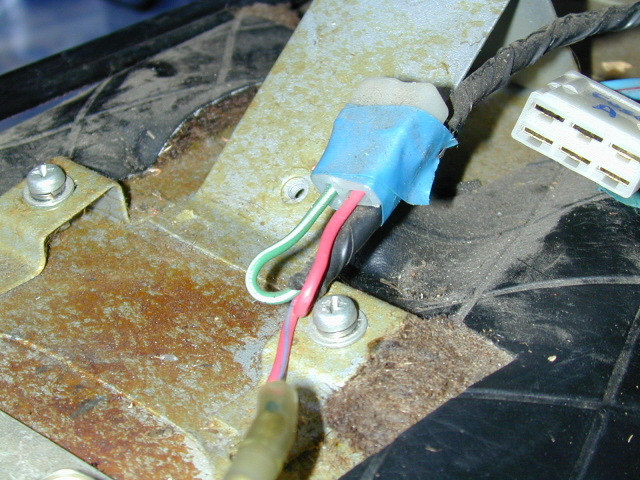

As an aside, if you look at the last picture, you'll see a 2 wire connector that's taped to the harness with blue tape. Take a look at the colors of the wires. They are Red and Green/White. That is the connector that goes to the Fog Lamp Switch, and presumably a fuse could also be installed there, but none of the schematics show an inline fuse for the fog lamp. All you need to do is to insert a switch here to control the Fog Lamps plugged into the original wiring connectors up at the front of the car.

So, if I understand, the blue taped female connector would be for the fog lamps but why did I found a male connector and it relies to the electric fuel pump?
That's Picture #4, and I included it ONLY to show how people would find it. It has nothing to do with the Fuel Pump. It was a point of interest picture only. And ONLY because we were in the same area and the connector was immediately to the side of the Fuel Pump Fuse.
Don't read more into it than that.

Male/Female Connector labels can get confusing when you're referring to the METAL or to the PLASTIC. Typically SPADE connectors are mounted such that the MALE METAL spade ends up MOUNTED in the FEMALE PLASTIC connector and viceversa.
So take a look at pictures 2 and 3 and you'll see that the In-Line Fuse Holder is connected to a Female Plastic housing that holds two Male Spade connectors.
Since you do NOT currently have the fuse holder connected and in the circuitry (because you connected to the light circuit), you would have a Male Plastic Connector holding two Female Metal Spade connectors in it.
Hopefully this clarifies rather than creating more confusion.
That you don't have the white fuse holders is because you didn't have the Fuel Pump Relay Fuse mounted at a dealer back in the day. I mention what it's for for those people that have the white clips and don't know what they're for.
As far as locating that connector, it should be right behind the Fuse Box, and should be easily located. At worst, you might have to move the fuse box by unscrewing it from the hump bracket, but that should really be all it should take.
