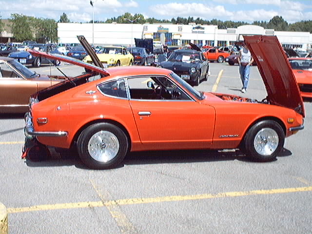

June 14, 200619 yr Author comment_170948 Thanks guys. I'm probably going to go woth the Falken Ziex ZE-512 in a 205 60 14 for now. If I can't get those, I'll just run some more 195 70's until I find some decent 15 inch rims, maybe the Konig Rewind. Sean240z, your car looks good with those Falkens! Link to comment https://www.classiczcars.com/forums/topic/20401-your-opinion-on-tires/?&page=2#findComment-170948 Share on other sites More sharing options...
