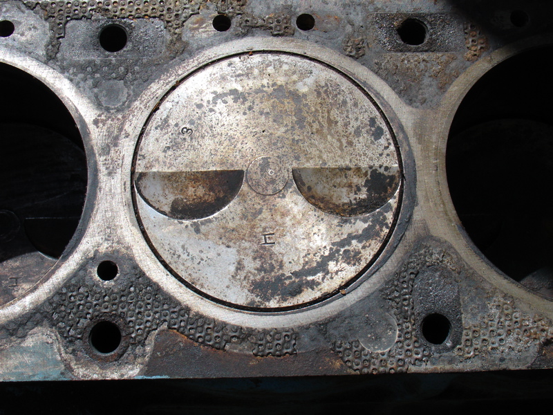

Update - First, comparing the engine number of my L24 to those on the ZHome.com register, I have decided that my engine is - in fact - from a '73. Not a '72 as I was told. It does have the valve reliefs in all 6 pistons.
As best I can measure (not having a micrometer handy today), the bores appear to be the stock 83 mm, so I don't think it has been bored before. Which is good, since I did more cleaning and am now certain that the cylinder walls are pitted.
On the other hand, take a look at the attached picture. Note the stamped numeral '3' towards the front on the non-valve side of the piston. All six pistons have the 'H' stamp on them, and cyl. 1-5 have the '3'. But cyl. 6 has a '2' instead. Do these look like factory pistons to you guys? Or are they oversize, the first 5 being .030" over and the 6th being .020" over?

Arne,
I'd stick a flat top replacement piston in, with or w/out relief. Don't think it'll make much difference. I've dicussed with several fellow racers about compression ratio changes on the 73 versus 70-72 engines. Those valve reliefs and large chamber size of 73 E88 head, dropped the squezzing ratio quite a bit. Piston (73) may sit up a hair more, but should work. Keep a handle on over reving, missing shifts, fresh springs should keep those valves off the piston tops.........
I'd investigate options on piston overbore sizes reasonably priced, then have block work done to see how deep a bore it takes to clean up.....
david
