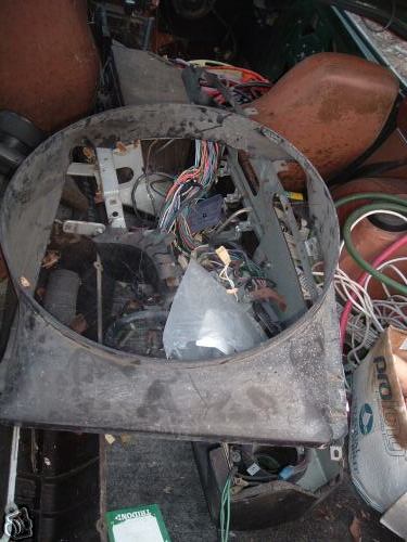

Garth, here's a pic of the one piece metal fan shroud. Just snagged it off the ebay listing for car #913.
As you look at the pic, the top of the shroud is on the left.
