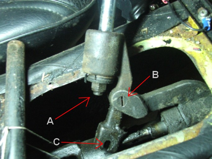

Howdy all. One last thing before I can yank the engine. I have attached a picture of the shifter, and have a question. As you can see, each attachment point is has a letter. What I need to know is if you guys removed both B and C, or were able to get by with removing "A", and just removing the chrome shifter. What I had in mind as you can tell by the pic, is removing B and C, but the flat head screw (B) is gonna be a tough cookie. I tried a large flathead with an adjustable wrench on the flat part of the blade for assistance, but I am worried that I am gonna booger up the screw.....that turkey is ultra tight.
Didn't know if the trannie would drop down far enough to clear without removing the entire mech. Let me know.....and thanks in advance. :D
Sometimes the most obvious choice IS the right one. Remove "A".
Good deal. Will remove A. Was just worried that the rest sticking up might not clear, but will find out soon enough. Thanks again.

My FSM for '71 says to just remove the lever. Should be plenty of room.

The '72 and later bodies use the Type B transmissions. These later transmissions have the shifter located farther forward on the transmission than the Type A transmissions found in the '70-'71 bodies. As montoya_fan01 mentioned you would have to enlarge the transmission tunnel hole and modify the console. Your shifter picture is from a Type A transmission, but your sig states a '72.
