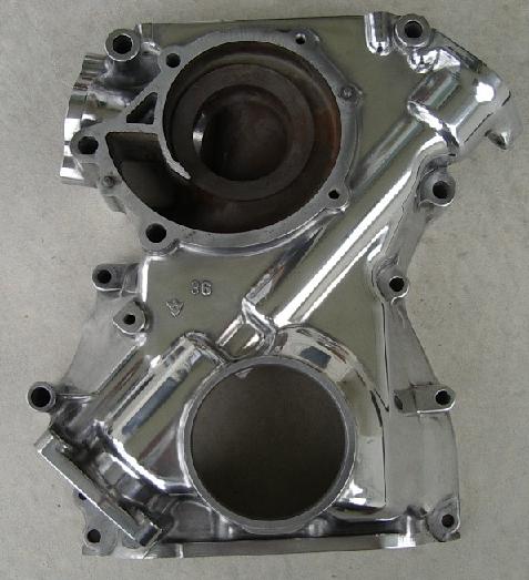

Which bolt broke on you? If you notice on the attached picture there are 5 bolts that hold the pump. The two on the right at the 1 oclock and 4 oclock position are threaded into the cover. The two large and long bolts at 7 oclock and 9 oclock are bolted to the block and then there is the long skinny bolt at 11 oclock which is also threaded into the block.
Hey thanks for the responses. Curtis, I had the same thought about how thick the timing cover was. If it's too thin then tapping threads may puncture a hole causing an oil leak. Hey Ed, I broke the 12mm bolt in the 7 o'clock position. How well will the pump remained sealed without it? By the position of it I'm assuming it serves as a major contributor to the pump remaining sealed correctly. If I do remove the timing cover, should I change anything while I'm in there? Thanks, Chris
