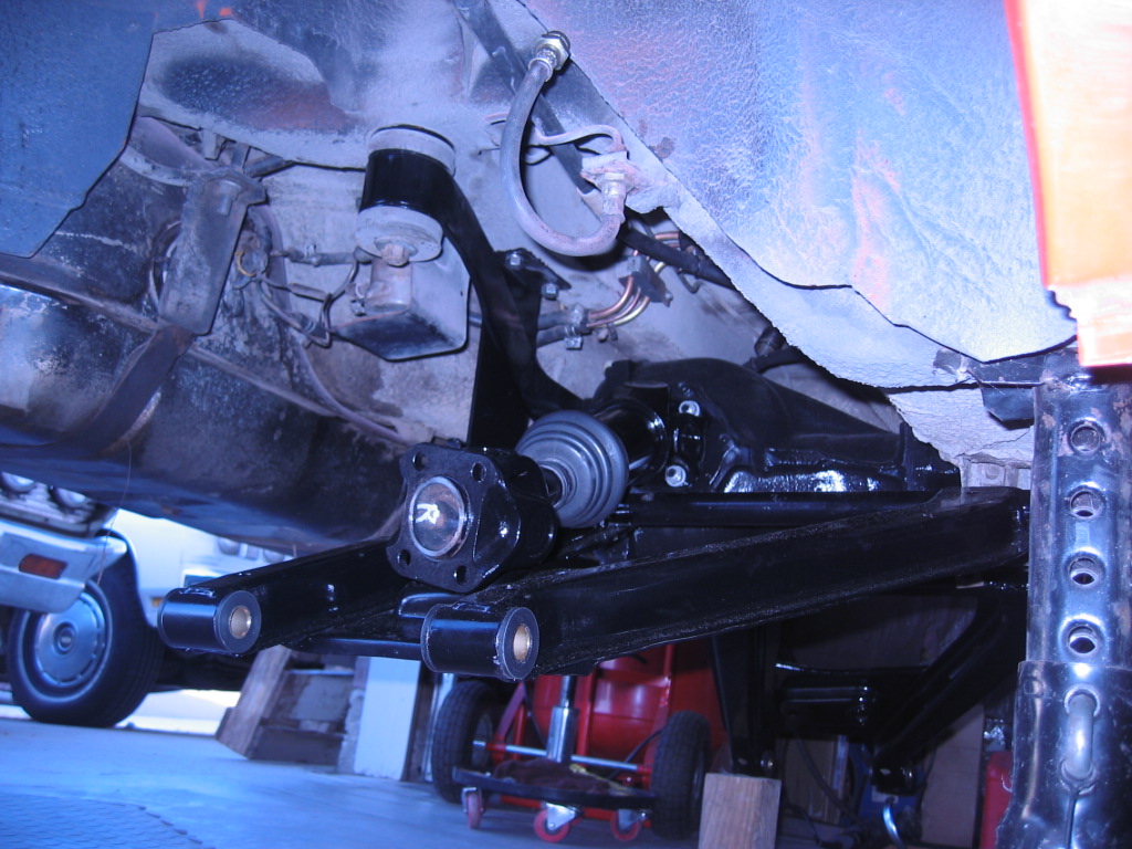

I have the Energy Suspension urethane bushings on my Z. The spindle pin bushings that mount in the transverse link have a metal sleeve that is inserted into the urethane bushing halves. The spindle pin then slides into the metal sleeve. Not sure what VB sells or how it compares to the ES bushings. You can see the sleeves I'm referring to in these photos.

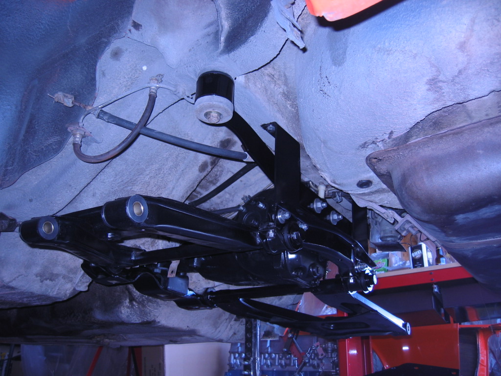

2) Ken: Those look like new fuel/brake lines in pic #2....If they are, where'd you get 'em?

The fuel/brake lines are the original ones. I cleaned them up throroughly and painted them with Eastwood's Cadmium paint. Here's a link to a thread on the subject: http://www.classiczcars.com/forums/showthread.php?t=19775&highlight=eastwood+cadmium+paint :smoke:
