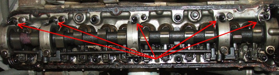

Hey.....this will be short and sweet. What I need to know is which headbolts are the longest. I will be running back by the junkyard Monday, and I need some headbolts for my engine stand. I have attached a picture below, with the bolts I am guessing are the longest, since they pass thru the cam towers. Click on the pic if you will and let me know if I have made the right assumption. Sorry for the lame question, but this will save me a bit of time. :)
Thought I would take this thread to mention my experience with re-building my engine L24-2338. This is an early engine - E31 head - the one that comes with the reinforcing plate on the oil pan because the crankshaft harmonics are out of whack. Later crankshafts have an added counterweight to rectify the problem, but the early engines are peculiar in that they have three head bolt lengths. I didn't notice the different lengths when I took the engine apart, but when I put it back together, I was forced to refer to the engine manual, page EM-30 which states; "Three different types of bolts are used. (So be careful when installing)". Everyone had been telling me to assemble the engine with new "turbo style" head bolts (I didn't want to do that) and after some research I was able to order new bolts in the various lengths from Datsun. I measured the block to determine which long bolts to use in which location. New turbo bolts would have bottomed out.

MikeW, got the correct hex/socket I need ready to go. Thanks. Gonna carry a breaker bar with me and see how it goes.
26th-Z, thanks also for your info. I found out a week or so ago about the 3 different sizes. Dropped by the local Nissan dealership with thoughts of possibly ordering some. The guy gave me 3 part numbers, and a price sheet showing me how proud they were of them. He said he was not sure if he could get them or not. No bother.....the local junkyard has all I need. As mentioned earlier, I will be using them for the engine stand, so I just wanted to make sure I got the longer ones. Was not sure how much of a booger these would be to break loose, so now I know exactly which ones to shoot for without wasting time (lunch break).
