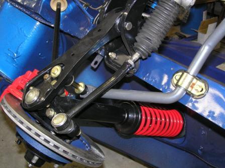

anyways, here is some pics of the whiteline BDF33 install that i did on the weekend, the swaybar is a little thicker than the original, but i am sure it is much stronger.. not too sure on the remaining stock bushes though :(

In the 2nd last photo, it looks like the D-bush clamp isn't seated against the metal (ie where it bolts down, it looks like there's a gap). Is this the case? If so, then make sure you use a spacer to fill the gap, so that you can bolt the clamp down hard against steel. Otherwise the bolts will break or come loose. If there's not a gap, then ignore my ramblings above:tapemouth
I would recommend replacing the end bushes too. These are a standard generic bush, that would fit most aftermarket swaybars. Replacing these will give you the most benefit from the new sway bar.

I don't remember there being a gap, it may just be the angle of the photo, but thanks, i will double check that.

i will take teh standard end bushes off again and drop into a suspension place, see if i can get replacement ones

Here is what my Motorsports sway bar looks like installed. Very similar in size and construction. The Z's arms are a bit shorter so it will be a stiffer ratio.
I too noticed the "gap" on the bushing mount. Did you use the stock brackets? The delron bushings do not 'crush' so they will not mount correctly with the stock brackets. If you put a SPACER under the bracket to keep the bushing in place, it will work just fine. Maybe a piece of 1/8" or 3/16" aluminum with a hole in it would work just fine. If you leave it the way it is, it will crush or crack the bushing and the sway bar will loosen up. Check it out!
