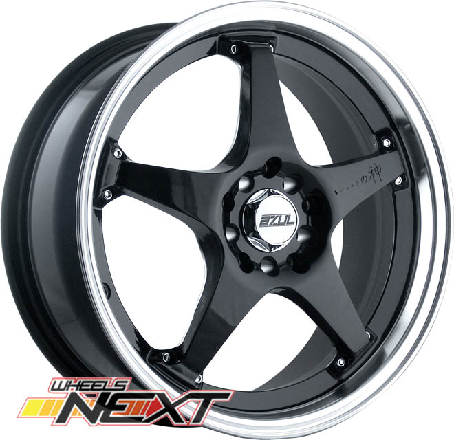

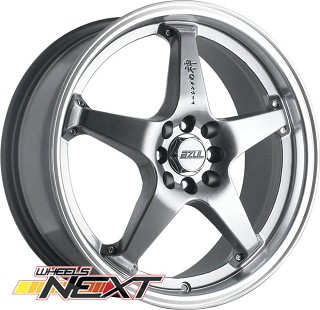

Ordering one of these Azul Speedstar rims this weekend from WheelsNEXT.com
and like to make sure I do this right :rambo:
Speedstar in BLACK (GLOSS FINISH)
Speedstar in HYPERBLACK
