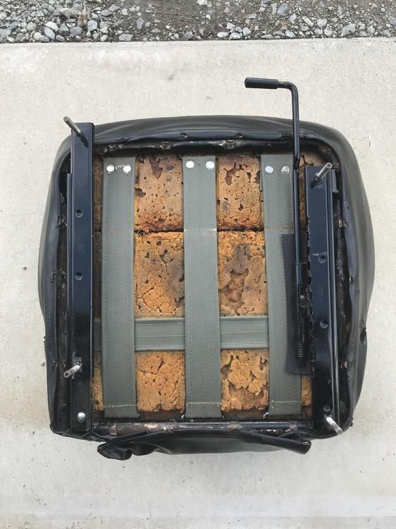

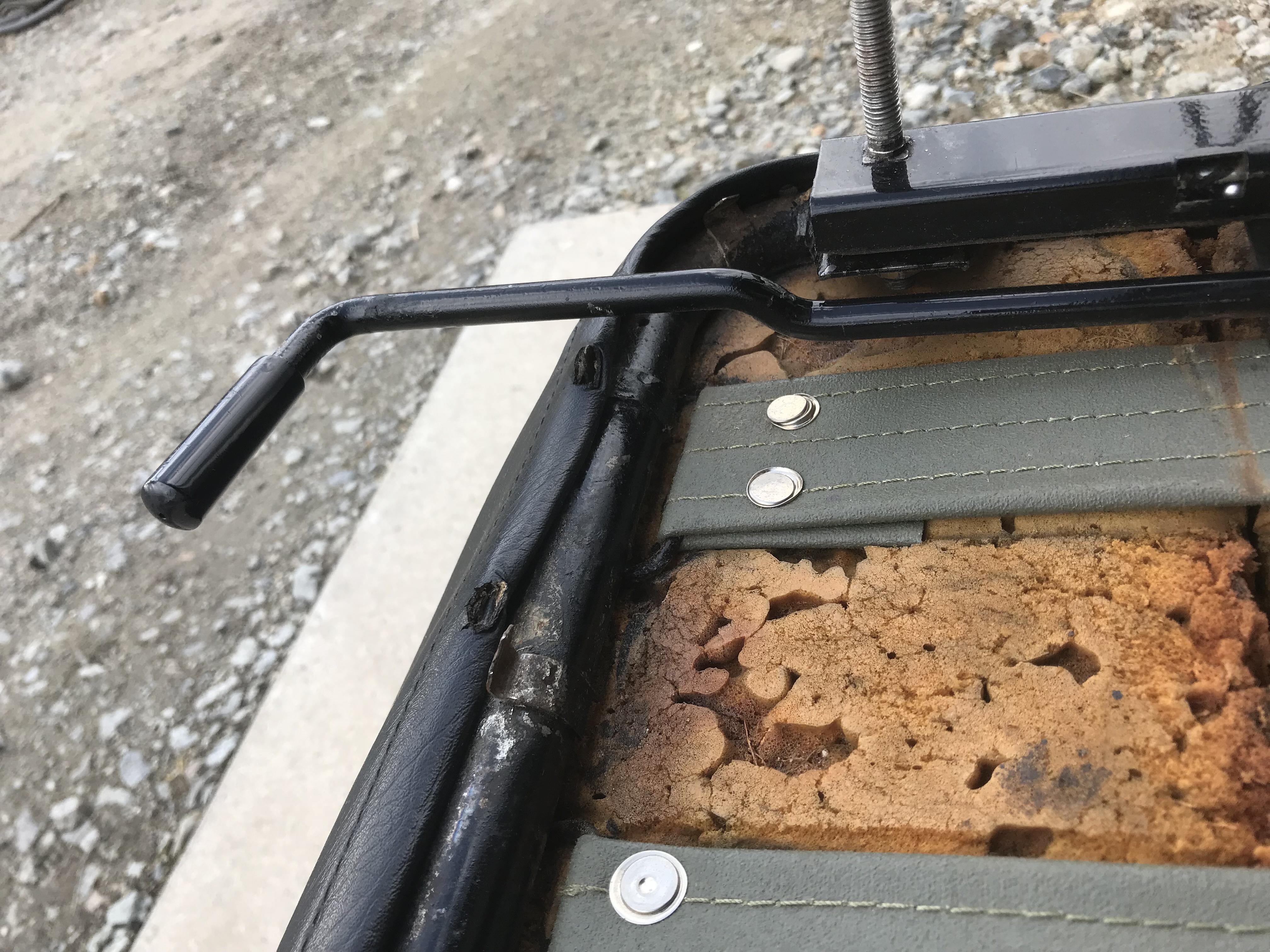

I found an interesting thing , the earliest seat sliding control lever looked like this , the “ S “ curve is located here , it is pretty forward than the later one . I think this early lever might be seen in up to Jan or Feb 1970 . How about yours ?

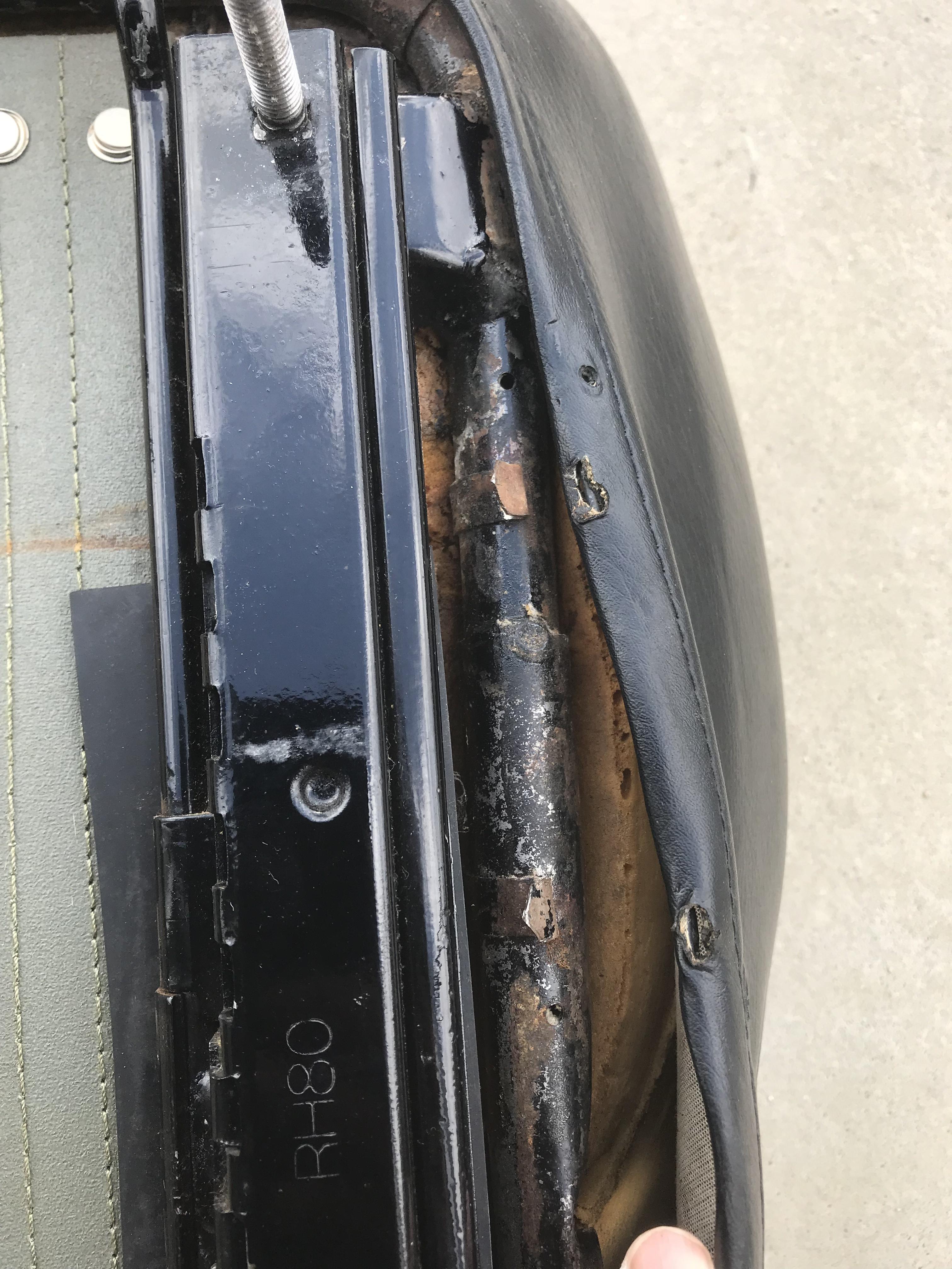

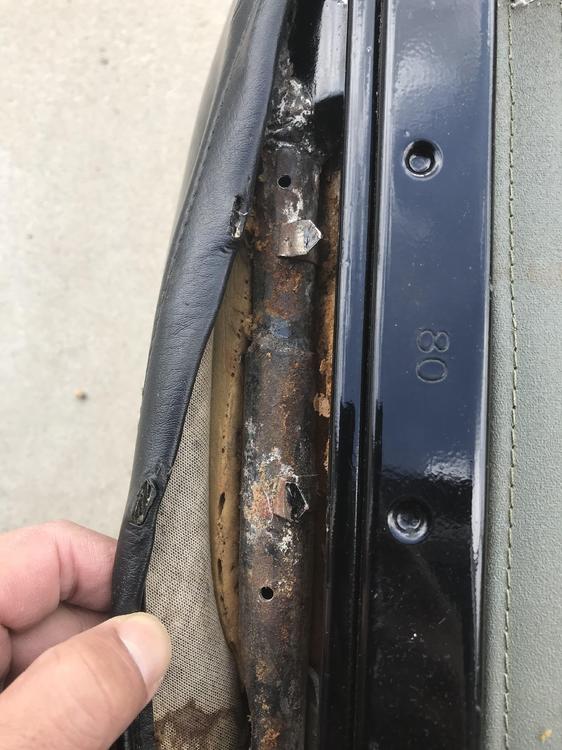

And I confirmed the holes for the plastic guards , the holes are set both sides  of the frame . So workers at the factory did not have to pay attention which is left seat or right seat .
( the seat in the pictures is 01/70 Z432, not original bands and not original color for the lever and the frame )
