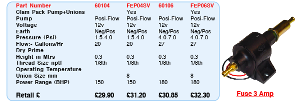

October 15, 200519 yr comment_141907 Any feedback on this one? I've read that they are a bit noisy if they are rigidly mounted, but fairly quiet if rubber mounted. Obviously looking at the 4-7 PSI model. The brand is Facet, the model name is Posi-flow, and the one I'm looking at it the 4-7 PSI model on the far right. Link to comment https://www.classiczcars.com/forums/topic/17617-240z-fuel-pump-alternative/#findComment-141907 Share on other sites More sharing options...
October 15, 200519 yr comment_141912 If you rubber mount it . It should be ok for noise , it's the pulsating type that rattle and make all the racket. I just wonder about the 7 psi. . You are aproching double the pressure that is recommended . If you could get one of the pumps Enigma was talking about for $10 or 15 bucks . I would be tempted to go that route. In fact I think I will look for one of them my self. As long as we are talking electric fuel pumts . There is safety issue here. On these early cars there is no shutoff other than the key switch to stop the pump. In the event of a crash or upset the fuel will continue to pump as long as the key is in the run position. The addition of a INERTIA SWITCH , I think is a great addition. I have one from a Ford truck that was given to me by a member and it is going on my Z . Part # E7AE-9341-AA It is a simple devise that will trip in a collision and it has a red reset button on the top. I did install a pressure switch on the oil outlet along with the sending unit so that the fuel pump would be shutoff when there was less than 5 psi oil pressure . I think the inertia switch is a better idea. The pressure switch would however save the engine in the event of a oil pump failure . However it would only work on non injected cars. Gary Link to comment https://www.classiczcars.com/forums/topic/17617-240z-fuel-pump-alternative/#findComment-141912 Share on other sites More sharing options...

October 15, 200519 yr comment_141923 I was planning on the oil pressure shut off as well, I've had other cars that came from the factory with that system, seems to work well. As for the pressure, they make the same pump in a 1.5-4 PSI version as well. I just wonder if that would be enough. Not that trust them entirely, but I note that MSA sells a Holley pump that they say has a 7 PSI max as well. Bryan Little's site recommends 3-5 PSI. My problem is mainly that I want to get the pump as cheaply as I can, to save money for more fun parts. Link to comment https://www.classiczcars.com/forums/topic/17617-240z-fuel-pump-alternative/#findComment-141923 Share on other sites More sharing options...
