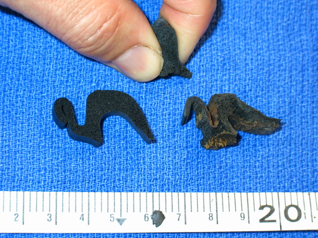

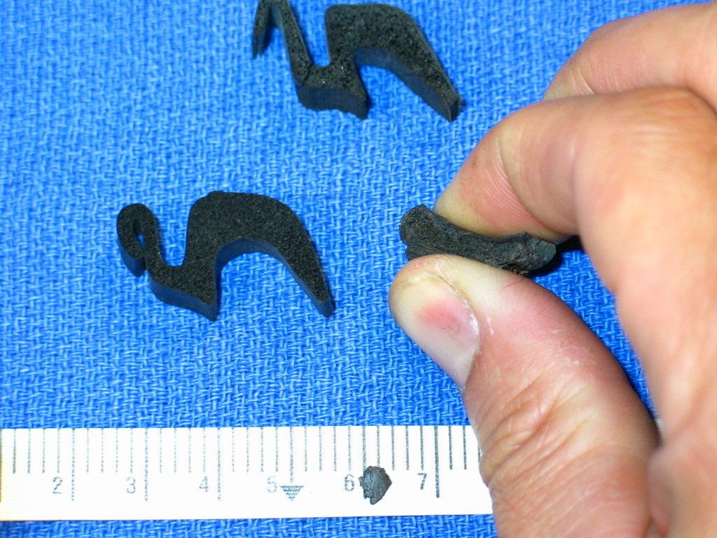

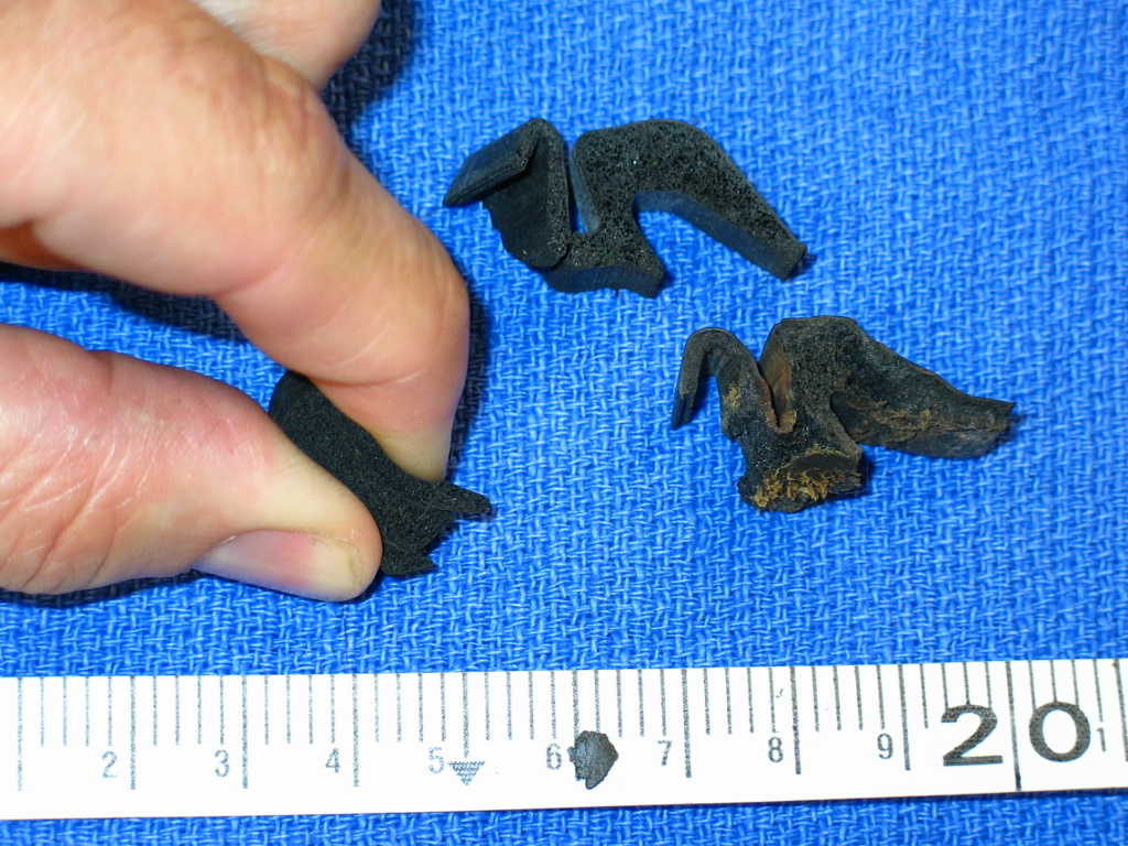

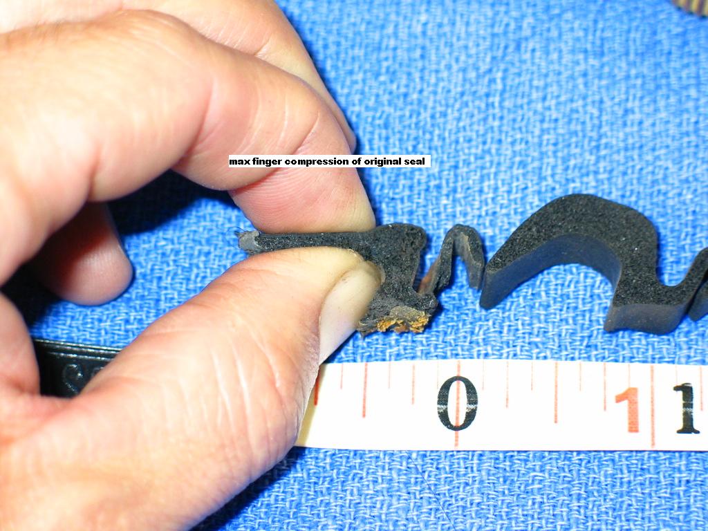

May 9, 200619 yr comment_166771 Soooooooo....a little more fuel to the fire OK, so I just dumped a ton o cash on MSA and VB replacement parts, some of which went to the weatherstripping department. Unlike Goose 52, I am choosing to retain the original welting and went with the "genuine" door weatherstrip, MSA part# 76802-E41 and 76801-E41. Pricing is around $64 a side. These options are listed currently on their website and not in the current catalog... First reaction out of the box was "&^%@#$@*, it's Precision!" But then I unwrapped it, and the door seal was--soft! It compressed easily. I took it down to my garage and compared it to the original 35-year strip I had saved when removing the old stuff: same profile, same softness! I temporarily installed one--it fit nearly perfectly along the paint line (car had been repainted red from original yellow), and the welting fit over it perfectly! Feeling like reminiscing over my days in gross anatomy and surgical pathology, I did some comparison pictures, submitted below...Now, of course ihave not installed it and closed the door, so this is not definitive--but it looks pretty dang close to me! Steve Link to comment https://www.classiczcars.com/forums/topic/17269-jc-whitney-door-seals/?&page=4#findComment-166771 Share on other sites More sharing options...
May 9, 200619 yr comment_166777 Yep - I had 5 different types of seals all laid out on the counter at MSA and the "genuine" 2-pc seals were indeed softer than the Precision 2-pc. I went with the 1-pc (attached welting) as that was what was on the car and I knew that they had worked before. I guess I must have had the seals replaced back in 1987 during the repaint after all - at that time the 280z-type 1-pc must have been installed. After all the changes I've made to the car over nearly 34 years, I wasn't concerned about originality - just what would work.Like you say, the proof of the pudding is when you try to close the door. I'm sure all the folks that are on-the-fence about which to buy will be interested in hearing how the "genuines" work in your car - make sure you report back when you get them installed! Link to comment https://www.classiczcars.com/forums/topic/17269-jc-whitney-door-seals/?&page=4#findComment-166777 Share on other sites More sharing options...

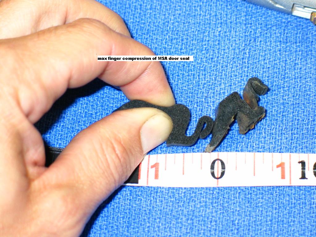

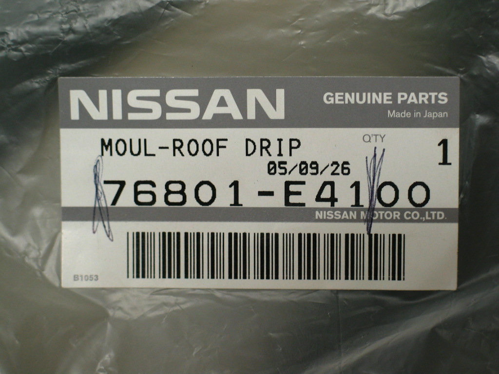

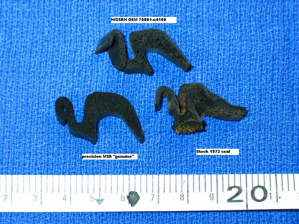

May 11, 200619 yr comment_167079 So when I ordered the "genuine" door frame seals from MSA the other day I only got the driver's side--passenger's side was on backorder. It shipped on Monday and arrived today--in a Nissan bag! I thought these were NLA, but lo and behold, there it was! Had the correct part number on it and everything. I firmly believe these are the correct seals to order. Here's the pics, with compression... Steve Link to comment https://www.classiczcars.com/forums/topic/17269-jc-whitney-door-seals/?&page=4#findComment-167079 Share on other sites More sharing options...

May 11, 200619 yr Author comment_167093 Hey Xray, nice comparison. You can clearly see the difference in the construction of the different seals. The Precision two piece looks denser than the OEM. After slamming my door for several months with the JC whitney seals I went with the Precision 1 piece (with attached welting $69.95 from MSA) the door closes much easier now. I even had to adjust the window frame to seal better. So my vote is that the Precision two piece is the thickest. Then followed by the JC Whitney one piece and last the Precision one piece. I'm not sure where the OEM falls in. Link to comment https://www.classiczcars.com/forums/topic/17269-jc-whitney-door-seals/?&page=4#findComment-167093 Share on other sites More sharing options...

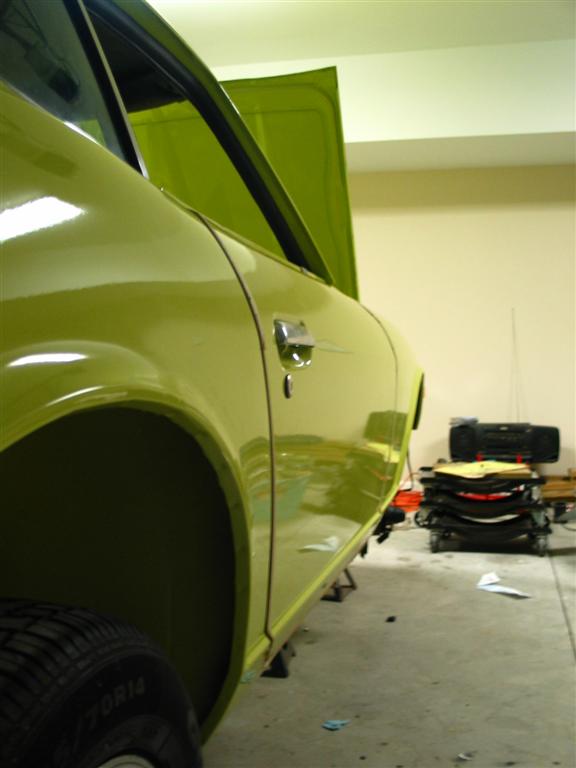

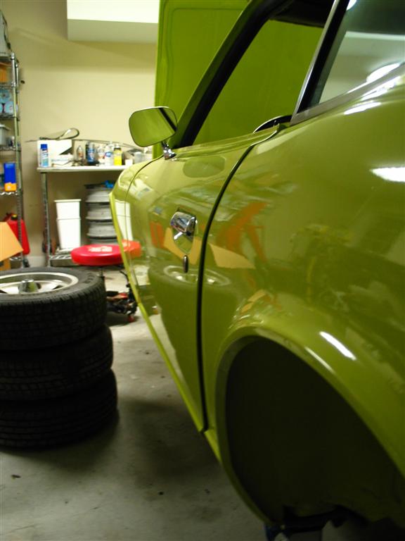

August 5, 200717 yr comment_217466 Sorry to drag this up, but wanted to demonstrate on the car how the two seals I mentioned previously compare side-by-side. So..passenger side is Nissan OEM, driver's side is MSA/Precision "genuine" seal. Both were used with re-mounting the OEM welting. Both went on easily, no problems. You could probably tell how this ends up by looking at post #41...the MSA seal is just a little denser, and the outside flange doesn't have the same arc as the Nisdsan one does. Nissan seal allowed door to close flush with no effort (aside from a little door adjustment.) MSA "genuine" seal fit almost as well, but left some gappage at the rear bottom. Should compress enough over time. My conclusion is this: Balance your desire for door slamming and improper closure against your bank account, and buy accordingly. Nissan OEM is more expensive but worth it since the door seals and shuts correctly the first time. Steve Link to comment https://www.classiczcars.com/forums/topic/17269-jc-whitney-door-seals/?&page=4#findComment-217466 Share on other sites More sharing options...
