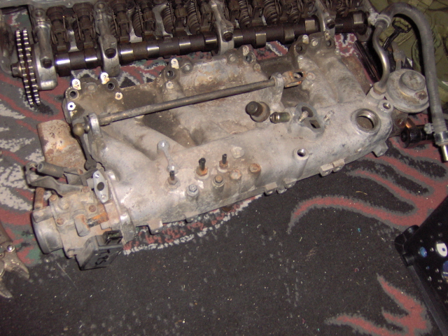

I am stuck on what to cut off and what to keep in the turbo intake manifold. I know I might need to keep some of the holes but which ones and where do the lines go? If you have pictures of your install, I would greatly apreceate it.
I don't want to get all crazy with cutting things off I might need.
Thanks

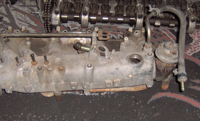

Brian,
Depends what you want to do I suppose. I used a non-turbo intake manifold as I couldn't find one and plan on making a custom one anyway.
I cut off the valve on the very end, then cleaned out the copious amounts of crap in the gallery that runs next to the plenum on the underside. I also discovered holes that go through this and into the runners! I tapped these and plugged them. I also converted to cable throttle and cut off the ugly towers.
Hope this helps,
Dave
