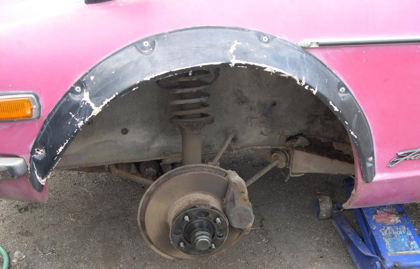

One last point I would make is that your car never left the Factory with those Overfenders attached. They would have been added later, either as genuine Sports Option parts or generic copies.

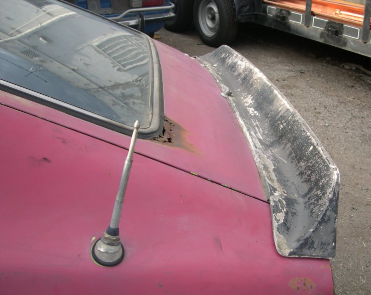

Heres a pic of the rear wing, its stock but to me seems
smooth.

That's correct for the manufacturing period of your car.
Only the earliest Factory rear spoilers had the reinforcement ribs. Differences are detailed in the two 'Home Market Options' threads I linked in my previous post, as far as I recall.

oh, the flares are riveted on
As for the miles, I have pretty good documention that came with the car, the car say in Hawaii for about 10 yrs, with very little miles put on the car, when the prev owner moved to SD at Camp Penelton, the car also sat as a 2nd car for many yrs on base and never moved, after the gentleman passed away several yrs ago the car just sat on base for another 10 yrs. Like you say it really doesnt matter, but its cool if I can verify the whole thing.
The air cleaner could even be the OE one too.
If the flares arent factory, Im probably going to remove
them for the meantime and during some of the restoration.
Ill keep them just in case I want to put them back on one day.

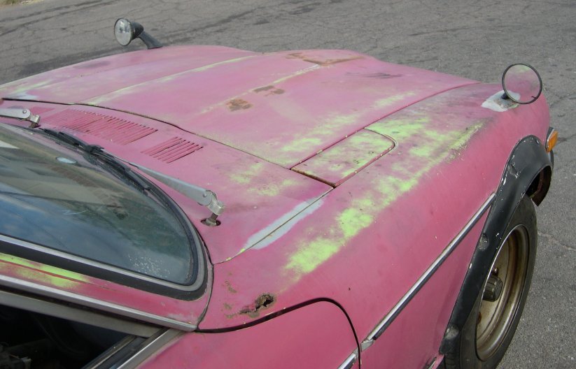

my car inside is orange, a factory color
outside its funny, theres a layer of lime green then the almost pink on top.
Has anyone heard of something called a G pkg ? from what I heard from 1 source that was suppose to come with the flares, special paint color and blacked out headlight buckets for starters.
That lime yellow I thought came on later in '71, the yellow I'm speaking of looks like in that brochure but your scheme is confusing, I thought the entire unibody(not the underside) was sprayed the body color. Mine originally was silver, I think the PO repainted but kept the original color, interior panels and the engine bay match...I then painted it white...is your color code sticker still intact? BTW, does your have a rear sway bar? I'd be interested to see how that was mounted...
smooth.
I noticed the white body filler plugs where the "Datsun" emblem would be without the wing on the hatch...I wondered if they actually did send them out that way...I was thinking about filling mine over (...there's a part # for that...)

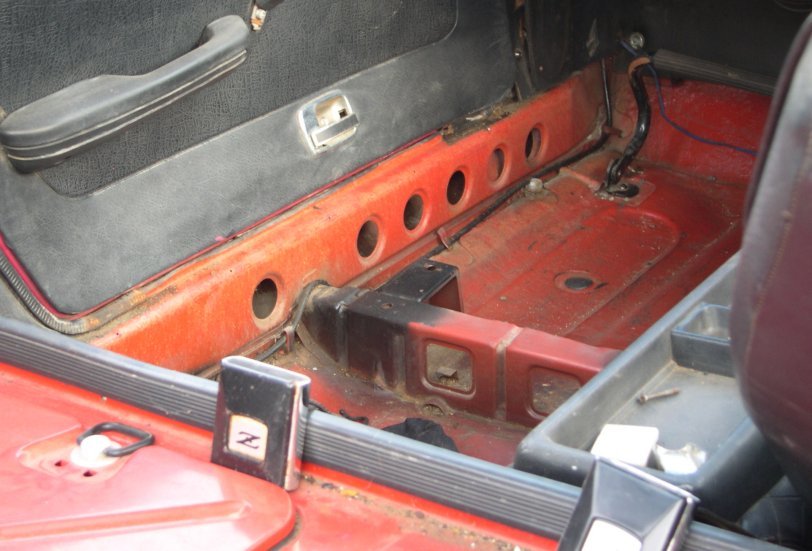

I saw that too..
What about the inside frame rails, looks like
they tried to lighten from the factory with a series of holes.
Are the US cars the same way ?
Dayle,
Those are the rocker panels, not the frame rails, and the holes are the standard fabrication for the S30 chassis. I'll make some other comments...
I agree with Ben and Alan that your car is probably the ZL model, probably because so many of the "options" are present. The ZL model included many of the items we see as "options". Your example includes several more items and judging from the age, I would suggest that your wheel flares are indeed "factory". They appear to be the same FRP material as the rear spoiler would have been. The headlight scoops would also be FRP. I am surprised to see the lack of headlight covers. The rubber strips on the bumpers are correct, however I am surprised to see the over riders on the front bumper. Does the car have a mesh grill? And how about the lower lip front spoiler? Would love to see a picture of the fog lamp remains.
