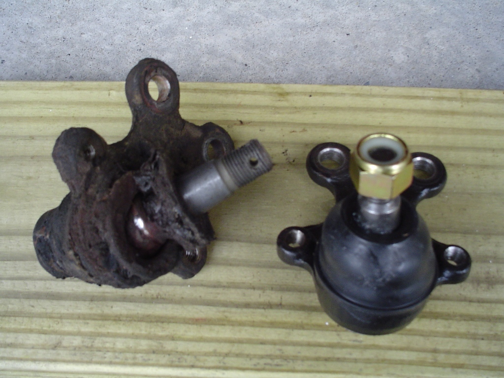

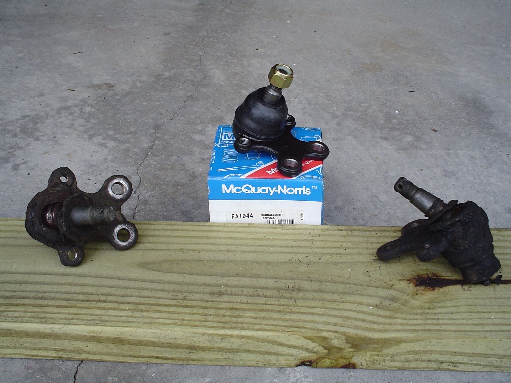

Here's a pic of the ball joints I just removed, I think they're still useable :stupid:
