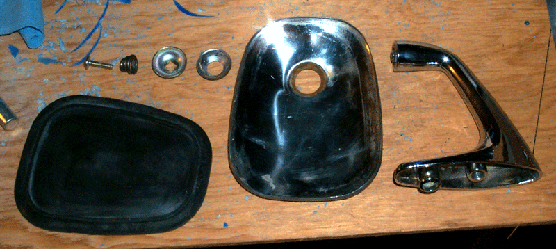

It will take some doing, the crimp has a healthy reach, and stainless is difficult to glue to, especially when the points of contact are all on the edge of the glass. Lets not forge the vibration and temperature/weather extreems this tiny area of adhesive will be expected to work in. OOps, there is also a rubber pad behind the mirror as well, it is not glued to anything, just positioned between the glass and the flag to absorb the shock from both crimping and travel. I will post a couple of pictures of the parts in a few minutes.
Will
Here are the pictures,
One of all the pieces, one of the crimp on the flag.
The flag crimp folds back over the flag by an eighth of an inch or so all the way around-putting a mirror back in it without folding out the crimp and then folding it back would leave an awfull lot of unsecurred area around the mirror, allowing to find its own resonance, and ultimatels fall out, break or both.
