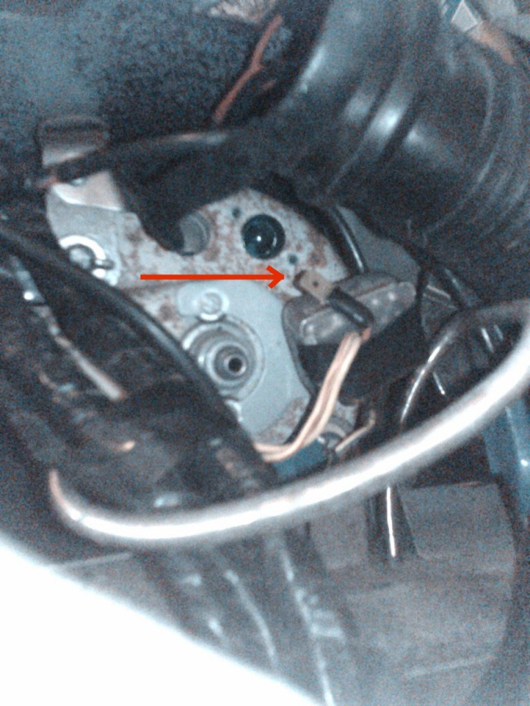

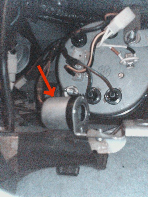

Posted April 27, 200520 yr comment_121867 I have a '73 240. I just pulled the dash and am ready to reinstall. My first question is in pic on the left, the arrow points to what seems a ground housing. I have an illumination bulb that has a socket that is different than any other socket under the dash. It just happens to fit inside it perfectly. does it go there? And secondly, what plugs into the male spade plug on the block on the back of my speedometer in the second pic? I hope these aren't dumb questions, I just want to make sure everything is plugged in correctly. Thanks! ~Richard Dr_Rich dr_rich007@hotmail.com Link to comment https://www.classiczcars.com/forums/topic/15733-dash-connection-question/ Share on other sites More sharing options...

April 27, 200520 yr comment_121907 I have a '73 240. I just pulled the dash and am ready to reinstall. My first question is in pic on the left, the arrow points to what seems a ground housing. I have an illumination bulb that has a socket that is different than any other socket under the dash. It just happens to fit inside it perfectly. does it go there?And secondly, what plugs into the male spade plug on the block on the back of my speedometer in the second pic? The first item is the Light Housing light source for the 4-Way Flasher Switch (Pull/Push Style) and the Cigar Lighter. The "odd" light bulb socket goes in there, and lights / dims with the normal dash illumination. The light to the 4-Way Flasher and the Cigar Lighter Housing is "sent" there via a Fiber Optic Cable. The FOC goes THROUGH the 4-Way Flasher STEM and then into the head of the Push/Pull Knob, on the Cigar Lighter it exits at a small hood that is attached to the side of the Cigar Lighter Body. It's a very nice subdued light effect.As far as the second item, that is a doozy. It looks as though it's coming from a relay or a small circuit box. The White Red and the other ?White/White? wire aren't one of the color codes used for that thin a wire. The White/Red wire they use tends to be heavier gage. This almost looks like a "Light On" Warning Buzzer but don't take that as what it is, just a WAG.Enrique Link to comment https://www.classiczcars.com/forums/topic/15733-dash-connection-question/#findComment-121907 Share on other sites More sharing options...
