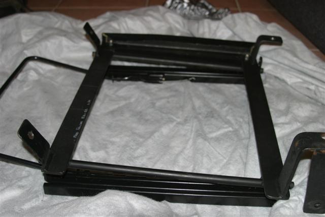

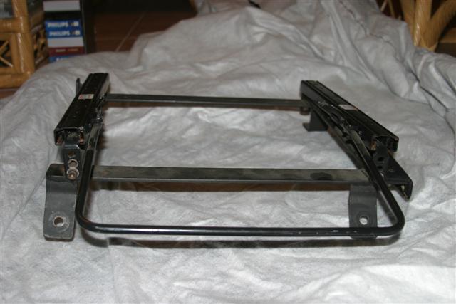

Hi Guys,
In the near future i am getting some seat mounting brackets made up to fit the 240k coupe (i assume that the sedan is the same mounts?).
These will be to fit recaro rails, but i am sure it wouldn't be hard to mount other seat rails..
Anyways, since i am getting a pair made, is there anyone else who wants a set made up, shouldn't be too hard to organise, and then we can halve the cost.
I am in Sydney, and will be using a mates family business, not sure on cost of them yet, as i need to get the rails and the stock C110 seats down to them to look at first.
Anyway, if anyone is interested let me know soon
https://www.classiczcars.com/forums/topic/15395-c110-seat-rails/
these are recaro rails for the EB falcon, but you can see what the C110 will be modelled on
I am only getting the bottom frame made up (from the large allen screw on the front down). hope it is clear enough

Hi Mikey,
they are looking at them now, they usually deal with bending sheet metal etc.. so they were talking about bending up a plate to match the contour of the floor (bolting to the mounts, which then had the tabs welded on to attach to the recaro rails.
the metal is going to be atleast 3mm thick, it would cost an absolute bomb to ship to the US i am afraid..
Probably better to find a metal fabricator in the US to custom make them?
I will take some pics when i get them back (they are doing a 1mm version first to get the right angles etc..)
