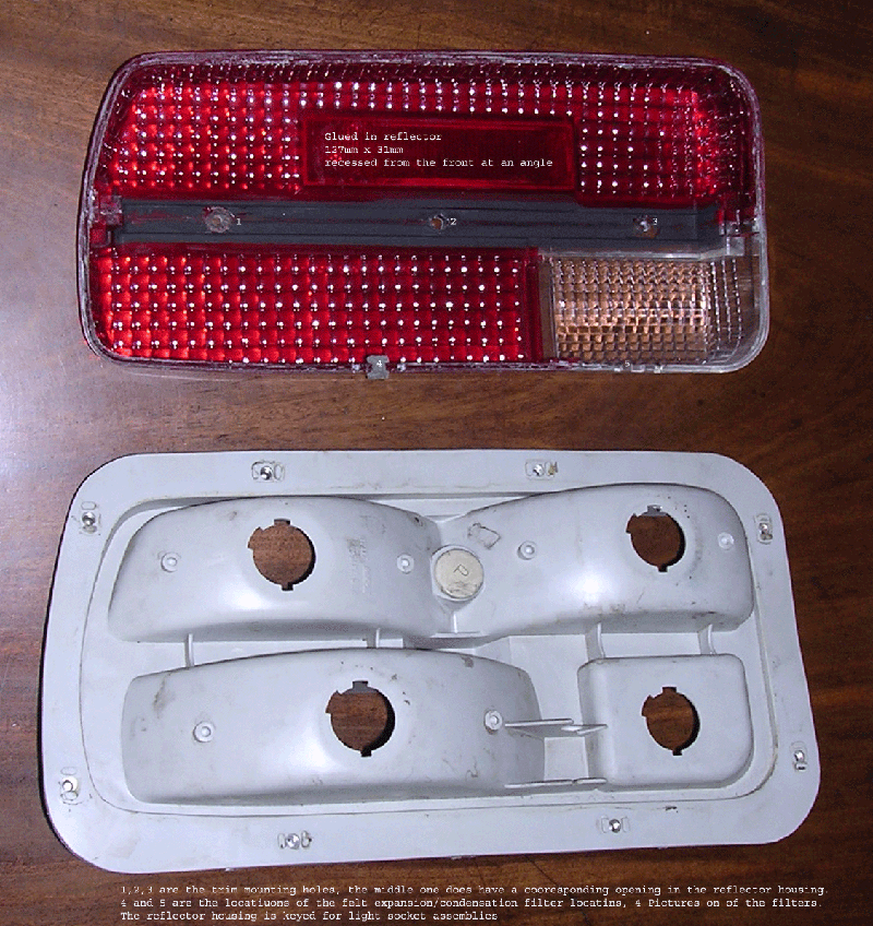

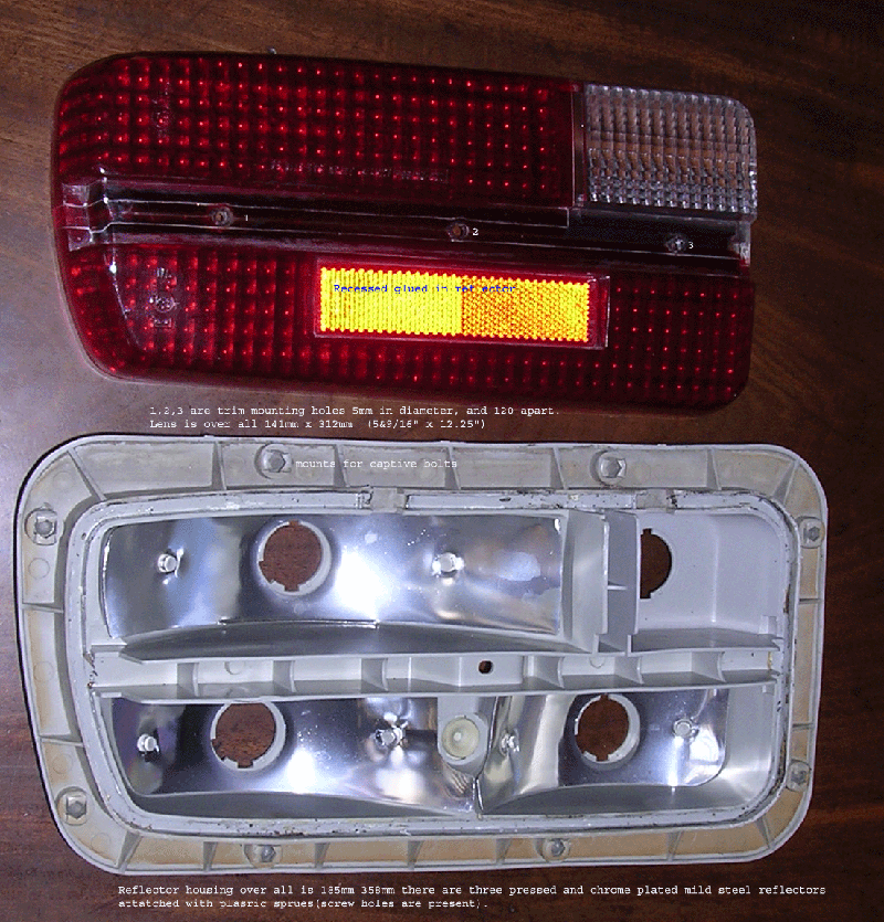

Sent message:
Hi,
Attatched, please find 3 high resolution photos with afew measurements and notes of and about the taillights I wrote to you about yesterday.
I can send a sample of the taillights is necessary.
Thank you,
William Stokes
Ps, I sent it to both addresses for you because hotmail may not allow files this large.
I did forget to address the chrome piece in the middle, but only because I am almost through with a solution for it!

From Tina at Klearz:
"... as you mention they are infact 1 peice lens. if the reflector is glued on, it would probably just be embeded in my reproduction, as in not removable.
i ajusted the quote on the z page on our website.
let me know if you have anymore questions
thanks for taking the time to send me those pictures.
Tina
> Date: Wed, 2 Mar 2005 09:30:52 -0800
Tina,
Is there a phone number I can call to talk about the lenses for a few minutes, the reflector in the lens is actually a 2 piece reflector guled into the lens, and I don't see a way to cast it in a single casting, and keep the reflectivity(it is smooth on both outer surfaces, and obviously jagged between the two pieces that are glued together and then glued into a hole in the lens.
> William Stokes
Hey there,
"...I see now what you mean about the reflectors being on the inside.
If the reflector can be detached from the lens we can cast it as a seperate peice no problem.
But it will be 10-20$ depending on the size of it.
Tina"

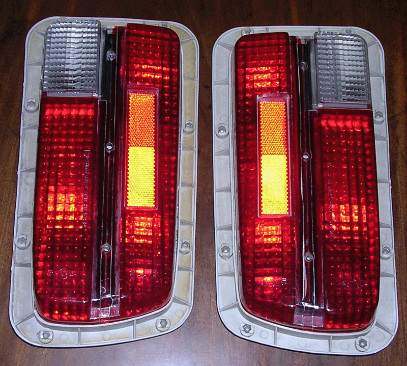

Will: What reflecter are you refering to? Is it in any of the pictures you posted? I've never had one of these apart and I guess I don't understand what it is and how it could reflect light "out" if it is glued to the lens (i.e. in between the light source and the lens)
The rectangle in the upper portion of the lense is a two piece (glued together) reflector(just like the reflector in a bicycle wheel) that is then glued into the lens.
The side markers are made the same way, but the body of the lens is one of the two pieces(I can post a picture of the side marker dissassembled if it will make this more clear).
I will take a stab at editing one of the previously posted pictures to make it more plain.
Ok, I need better lighting to take a photo that clearly shows that it is a seporate piece glued in.
Will
I see what you are saying now.
I was thinking more on the lines of the silver (curved) reflecters that are part of the rear "housing" of the tail lights. :stupid:
