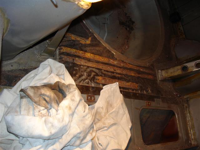

Yeah. the reason the floors rust out, it that the floors have no paint on them what so ever. The tarmat sound deadening was applied straight onto bare metal on the inside of the floor, and air pockets between the tar and the metal (like where there is a seam) start to rust over time (the paint was then sprayed over the tarmat) . On the outside the tar was sprayed on like paint. A couple of scrapes on kurbs and speed bumps, even stone chips, leaves exposed metal which then starts to rust.
If Nissan had painted the surfaces first, then applied the tar, there would be alot less rusty Z'z around.
I'd strip the tar off the interior of the Z because it may look fine, but there could be rust lurking underneath. Mine has some slight rust in the boot tray between the seats and the spare wheel well, where the curved indents are, that you would not have known was there untill it ate its way through the othere side. Glad I stripped all the tar out.
