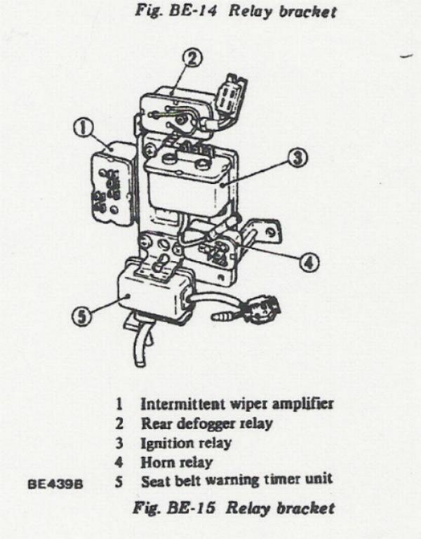

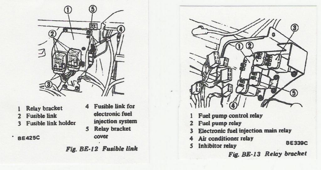

Here are two scans of the two relay locations for a 77-78. I don't know of one called specifically the 'accessory' relay. Might you be referring to the ignition relay? The only other relays not show here are the floor temp sensor relay and the brake warning lamp check relay. What is the number on the side of the relay you bought? If it's 25230-89958 that's the ign relay.

The earlier Z's didn't have an Ignition Relay, they had an Accessory Relay. It could be as simple as the old name sticking. The Acc Relay on the 71 controls most of the electrical items that need to be disconnected when the starter is engaged.
The Blue/White wire coming from the Ignition Relay on the color wiring diagram (nice job!) connects directly to the ACC connection on the Fuse Box.

Which leads me back to my original post (#4) in this thread. I kind of thought that you were referring to the ignition relay, #3 in the second attachment. A bad one could keep those electrical items Enrique mentioned disconnected (i.e. fuel pump) when the ignition is in the on position.
