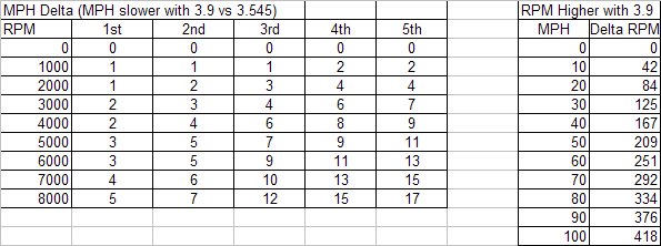

and I've put my own spreadsheet together comparing my '78 5 speed with the stock R200 3.545 versus the R200 3.90 that I have recently come into (see the attached pic for a table of my calcs). Essentially, at 70 MPH, I'm running less than 300 RPM higher (3211 vs 2919 RPM), and in that range, I'm losing around 7 MPH in 5th gear. Lower speeds have even less difference.
So, I know all the data. What I don't know, is how it feels to make this change? I do most of my driving around town, and/or around the local rural highways. I don't do more than 70 (or so) as a max speed anywhere anymore, and I'm really looking to pep up the acceleration a bit on the low end if this is a cheap way to do it. If I did this, I gather I would essentially have to shift more often (at lower speed), and the idea is that the engine would be kept closer to it's power band more of the time, and thus, as long as I shifted correctly, it would be able to, say, do zero to 60 a bit faster. So, for racers, or anyone who has done this specific '78 5 speed change to a 3.9 rear end, how did it feel? Were you happy with the result?
