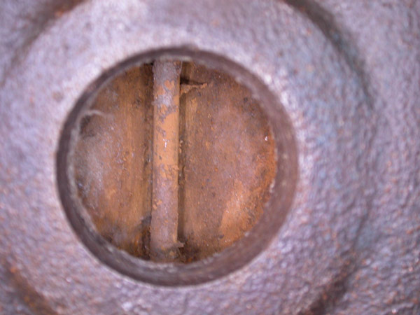

May 6, 200421 yr comment_79882 These ones? Link to comment https://www.classiczcars.com/forums/topic/11588-l28-f54-block-problems/#findComment-79882 Share on other sites More sharing options...

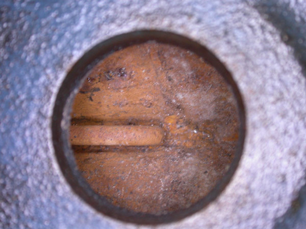

May 6, 200421 yr comment_79883 Another ( N42 block ): Link to comment https://www.classiczcars.com/forums/topic/11588-l28-f54-block-problems/#findComment-79883 Share on other sites More sharing options...

May 6, 200421 yr comment_79887 Guys,I spent most of my better years (younger) as a patternmaker. I was the guy that made cylinder heads/ blocks/wheels/ every kind of metal cast part----all out of wood (master patterns).I can't get to much information from the pictures, but I'm guessing that we are looking at chaplets, or nails. NAILS IN MY ENGINE!!??!! Yes.The engine block was formed by a cope and a drag pattern which formed the two main halves of the sand mold. Into the main mold halves went various other pieces of sand produced by coreboxes. These cores formed the cylinders, water jackets, some oil passages, and any areas that needed to be reorrientated in order to mold (patterns must always be larger at the BOTTOM than the top. "draft". Coreboxes must always be larger at the TOP than the bottom).Anyway, in the foundry some of the cores can be glued together and some must be "hung" from the top (cope) half of the mold. Those cores would be drilled with a wire and than a nail would be inserted (usually at an angle) to hold core in place.Though you can see parts of the nails (that area that was core sand) the ends are now part of the iron engine block. If you broke one of these don't worry. If you can get loose pieces out than go ahead. Link to comment https://www.classiczcars.com/forums/topic/11588-l28-f54-block-problems/#findComment-79887 Share on other sites More sharing options...
May 6, 200421 yr comment_79895 Yes, excellent description / explanation from Panchovisa.That's exactly what I was told about them; they are leftovers from the block casting process and breaking / damaging one of them is not a major problem. They certainly are not oil-carrying pipes or extra coolant passages, or anything like that.However, just as Panchovisa said, you don't want any broken pieces left in the block as they might find their way back to the water pump and damage the impeller.Great post, Panchovisa!Cheers,Alan T. Link to comment https://www.classiczcars.com/forums/topic/11588-l28-f54-block-problems/#findComment-79895 Share on other sites More sharing options...
