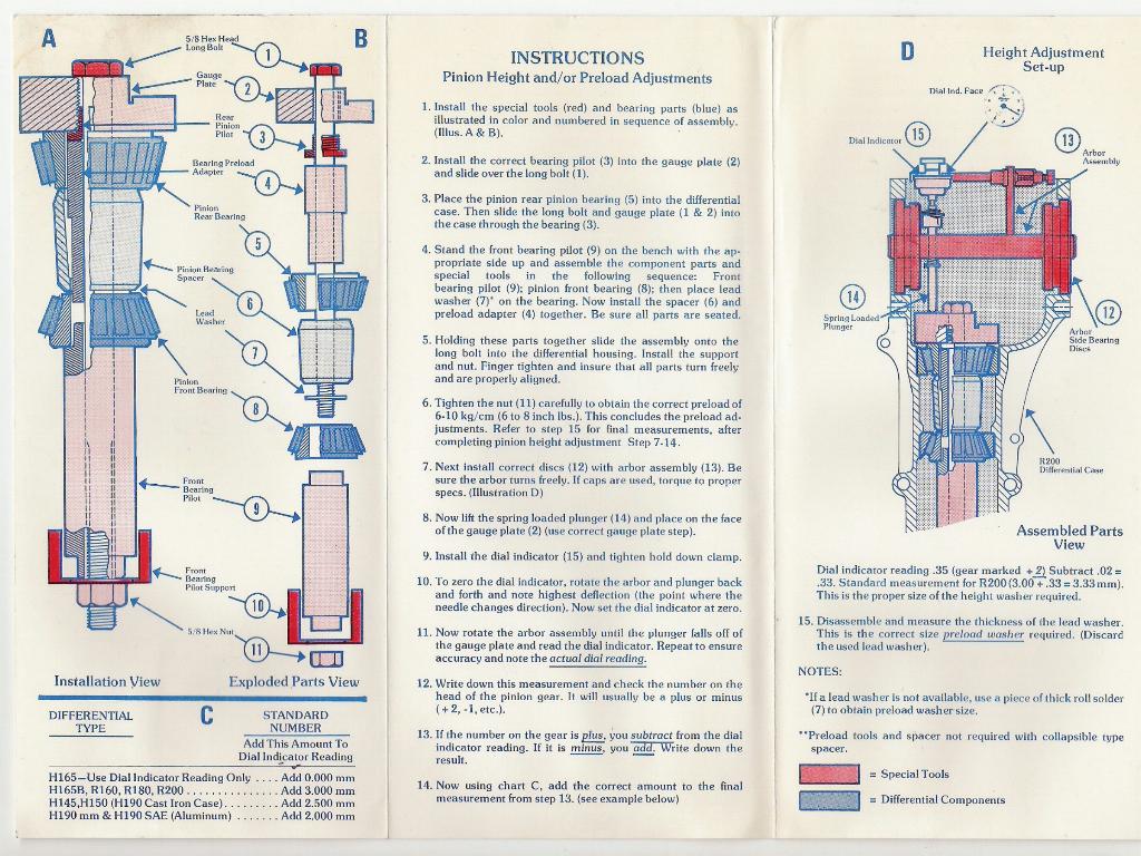

I found these in the junkyard today in the back of a 1980 280ZX. The first two scans are of a 'Datsun Differential Pinion Height & Preload Instructions' pamphlet. It seems to be from late 1976 or early 1977. I thought they might be of interest.
