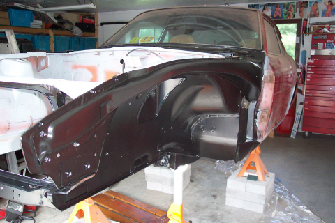

A safer place to put the jackstands in the rear is the short section of frame rail that runs just in front of the wheelwell, just on the outside of the control arm mounting point.
Best place in the front is on the frame rail just behind the T/C rod mount. Radiator supports can hide rust issues that you won't know about until it's too late.:cross-eye
Such as in this pic....sorry, I don't have a good pic of where I'm talking about in the rear.
I called it a radiator support, but if you look in the picture that 2mZ posted, you'll see the cross member support that goes accross the front end in the lower left of the picture.
Now if that is so rusty as to cause problems in jacking, you have a parts car candidate or some MAJOR work to do. Since it is a structural member of the front end, I would expect it to be strong enough to hold up the front end.
