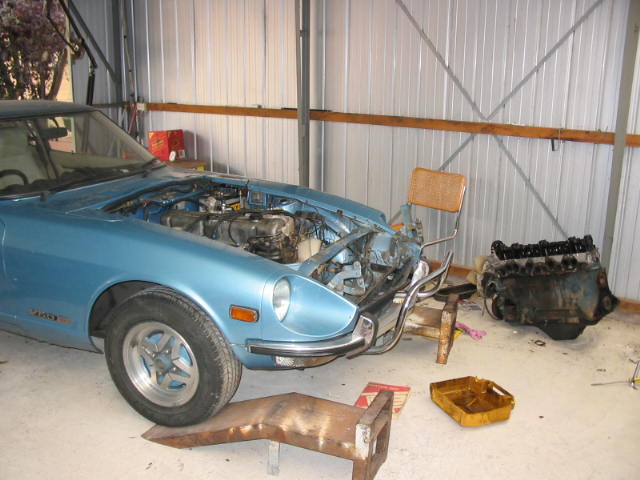

Anyone want to know what I been doin the last 6 months? Well I pulled out my blown 260 motor and have now dropped in a 280 (stock). Lots of running around but its finnally in! yeay!
Guess what? She dont want to start. The motor wount crank fast enough it seems. Battery is good as I pulled it out of a running regular driving car.
So I thought starter's drawin too much current. Pulled out the old starter and put in another one from wreckers, . ... And ... same problem. It just dont turn.
After a couple of rotations it wount turn at all. Symtoms of a flat battery right! So I got another battery and ......same prob. Last resort is to jump it, havent tried yet
any ideas?
