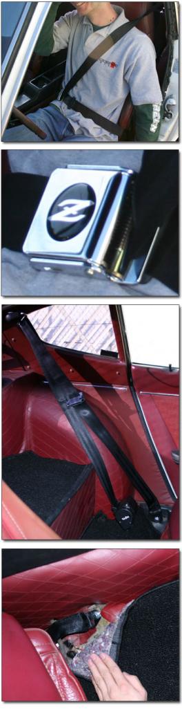

hi guys. i was wondering what options/upgrades has anyone fitted regarding seat belts?
MSA have a three point system for sale. looking at the pic though it looks like it may have issues with the seat sliding back.
anyone had one fitted or any advise on this issue?

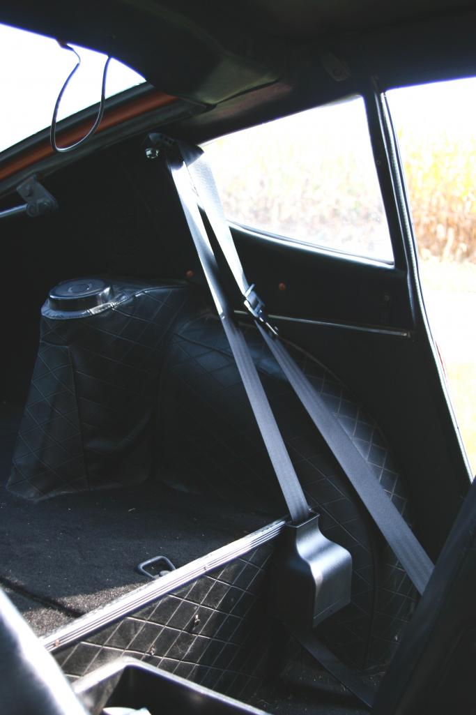

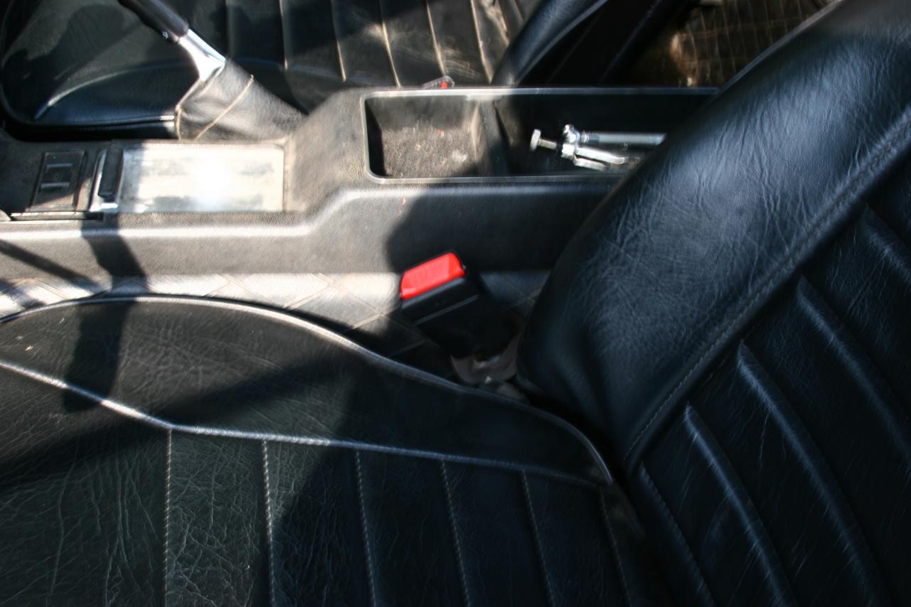

I Just installed the kit before Thanksgiving. Overall, I am happy with the kit, even though the retractor does not fit in the stock location. I can see your point about the rectractor touching the seat back if it is pushed all the way back. My original set was just too old and dirty to put back into a restored interior. Hope this helps!

...even though the retractor does not fit in the stock location.
The stock floorboard retractor pockets were added around 9/71. I know this because my 9/71 car came with the pockets but without actual retracting seat belts. The earlier non-retracting belts only needed one bolt at the floor mounting point instead of two bolts needed by the retractor mechanism. My car came with rubber plugs in the unused second bolt hole.
If the MSA system was designed to exactly replace the stock system they wouldn't work in '70 and '71 models and therefore they'd either be limiting their target audience or would need to have two separate systems depending on the model.
Mike,
Great point. After I read your post, I realized my wording was unclear. I should have indicated that my 1972 had the recess for the retractor unit, and in a perfect world, MSA's unit would fit in the stock recess. Thanks!
Bill
The shoulder belt in a 3 pt belt tends to rub on your neck in the S30. The stock shoulder belt is fine because you can add slack. A retractor based 3 pt keeps some tension on the belt at all times. It will vary depending on how tall you are, how you sit in the seat, etc. Most have no problems. The D loop mount geometry is not exactly ideal for both comfort and safety (only at the extreme limits) . I work at a place that makes seat belts and I designed a custom system for my Z. Dual sensitive retractor, high g buckle, high strength webbing. The dual sensitive retractor has to be oriented in a particular manner to work properly and I had to design a high strength steel bracket to tether the retractor to the original retractor mount points. It's way overkill as the car it's attached to doesn't have the structure to protect me in any crash that would stress the belt system.
