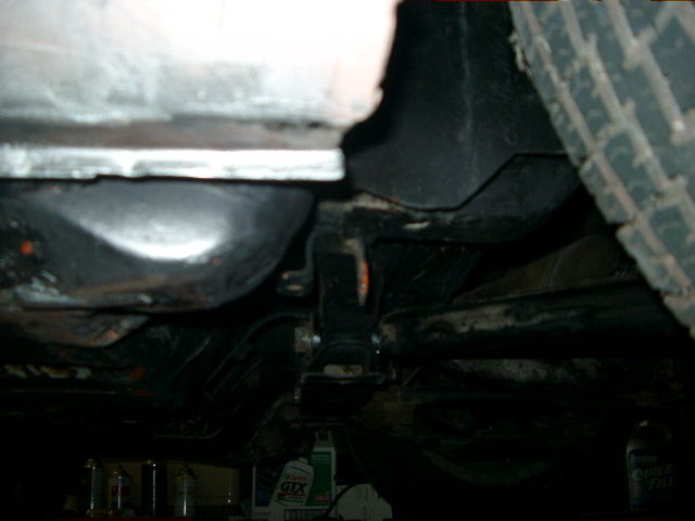

Here is the 11/72 alignment:
https://www.classiczcars.com/forums/topic/9044-240-vs-280-rear-stock-sway/

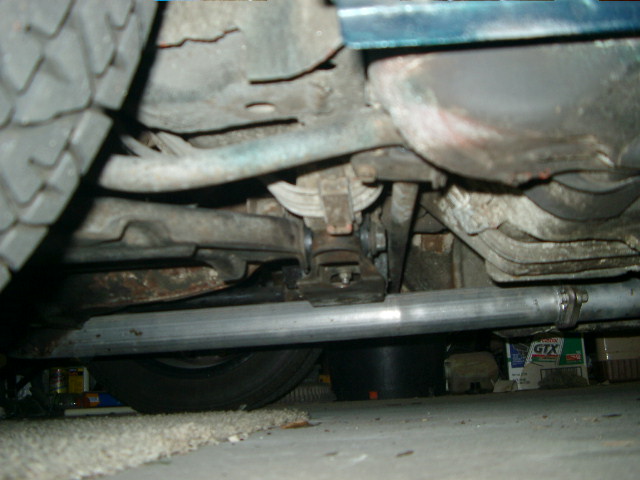

ok, the photo for the 11/72 is too dark to see. On my 72, with the bolt on mounting points, is about 3'' further aft than the location on your 280. Notice the location of the bracket in respect to the seat-belt-retractor pocket.
Does this look like the same location for the 73?
Yup, that's basically the same location as the factory mounts. I would still be interested in seeing a factory one. I know this has been discussed on an 'Alan' thread before, but don't remember the outcome. The brackets were welded on in US from '73-on, but were rear sway bars ever INSTALLED in them?

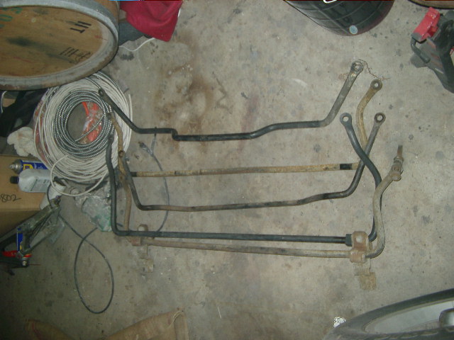

According to How to Hotrod and Race Your Datsun, all (presumably US) 240's were fitted with a 16mm front bar and no rear bar. The 260Z and 280Z models came fitted with a 18mm front bar and 20mm rear bar.
It seems that rear bars of various sizes were available from Nissan for the 240, they are kinked between the mount locations, the 260 on ones are straight there.
