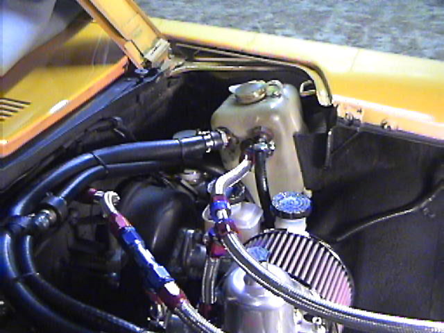

The 2 fuel bowl vent lines just go to a plastic fumes box that is stuffed under the fender. I don't have a stock filter where they would normally take the fumes to be recycled. There is a thread somewhere around here talking about this recently. Anyways heres a picture of the box.
