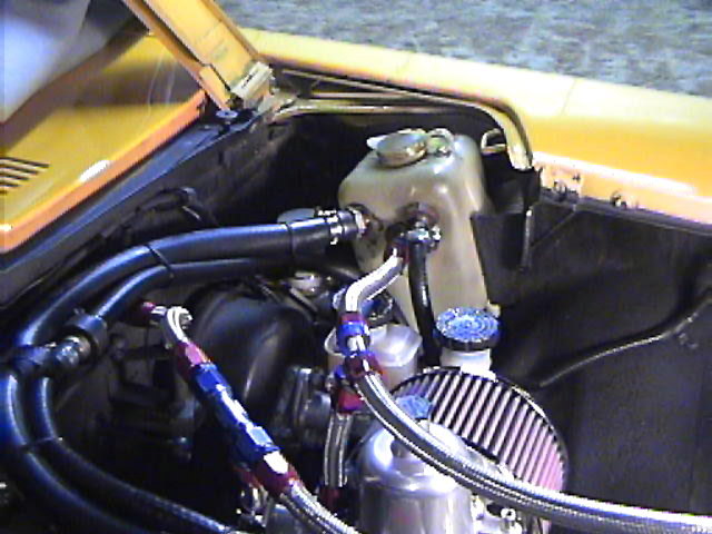

No don't plug it. Your car won't run with it plugged. It is a air vent and gas overflow port for the fuel bowls. Plugging it will not let the fuel exit the bottom of the bowl and thru the fuel line into the nozzle on the bottom of your carb. I run mine to a common oil / gas fumes vent- plastic- canister, then a vaccum line breaths it back into the cross pipe of my intake manifold. I do this because my Z only sees a race track and their requirements are they don't want open oil or gas breathers / filters since they can cause oil drips onto the track. Stock air boxes would have a port to plug a vent hose upto to take the gas fumes to dispose of them into the carbs. Your filter is custom so this is why you have no nipple for a hose.

The canister mentioned by chino is a good idea and you might want to look at the engine photos else where on this site.
take a look at chino 240z's gallery for a clue about my babbling.
good luck, and hope this helps.
Cool cool......the pics show it clearly. I'll try and rig something like that up.

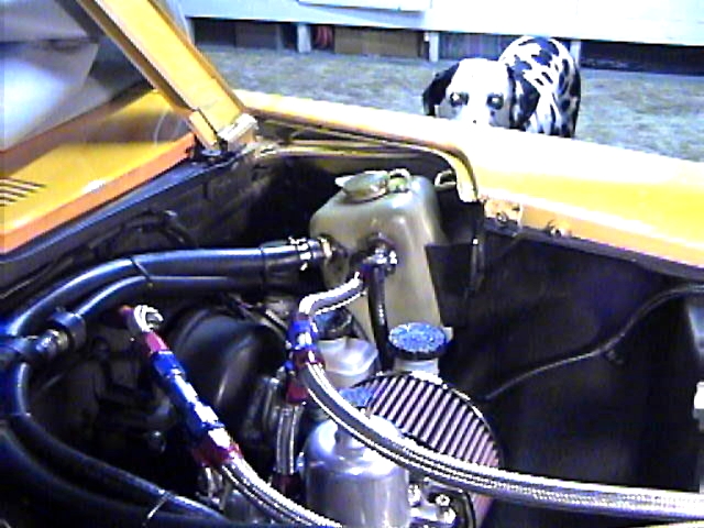

Okay here's the ugly part. It's just on old overflow container cramed into the corner with all the lines going to it and one coming from it to evacuate the fumes. I prefer the cool looking K&N filter vent idea, but on all my other cars they get messy and oily. This has been there for several years and has a few tablespoons of oil residue in the botton, I never empty it and is under the fender out of site, so its working good. As for the my dog Popcorn, she is always under my feet! Probably knows just about as much as I do about my cars.
