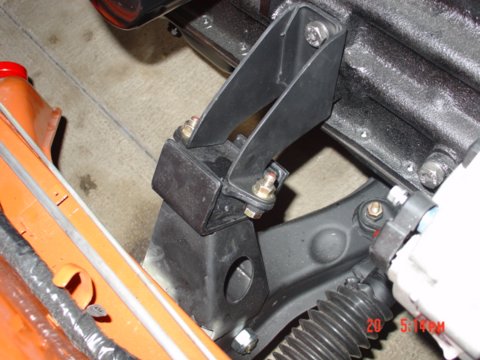

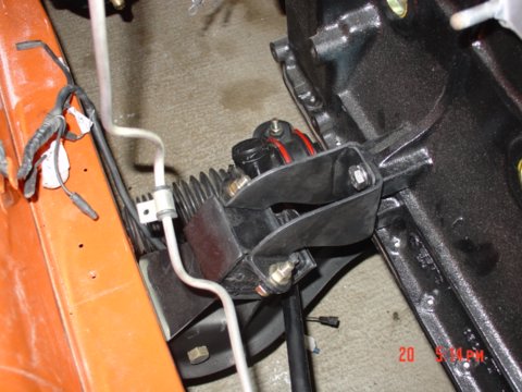

AFTER 18 MONTHS OF RESTO WORK I FINALLY PUT THE MOTOR IN THE CAR TODAY. I BOLTED UP THE ALUMINUM FLYWHEEL, INSTALLED THE NISMO CLUTCH AND THEN CONECTED THE 5 SPEED AND INSTALLED INTO MY 70 Z. AFTER BOLTING EVERYTHING DOWN, I NOTICED THAT THE TRANNY WAS SHIFTED TO FAR LEFT (IF YOU WERE SITTING IN THE CAR) AND THE SHIFTER WONT CLEAR THE OPENING IN THE TUNNEL. I AM USING THE STOCK TRANNY MOUNT WITH A 5 SPEED I THINK IS FROM A 78 280Z. IF THE HOLES ON THE MOTOR MOUNTS LINE UP, AND THE HOLES ON THE TRANSMISSION MOUNT LINE UP, WHY WOULD THE TRANNY BE SITTING WRONG.
ANY CLUES. SEE IMAGE BELOW AND CHECK OUT TODAYS GALLERY FOR TODAYS FUN.

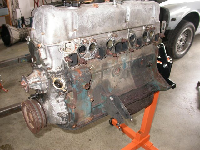

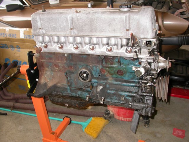

In case it helps, here's the right side of my motor just as it came out of the car:
i just looked. They look the same. See photo's below. Is it possible I have two the same.
those photo numbers are the same, and the pictures look identical; did you upload the same pic twice?

Mark:
The two photo's that you attached, are exactly the same. Same file name, etc.
