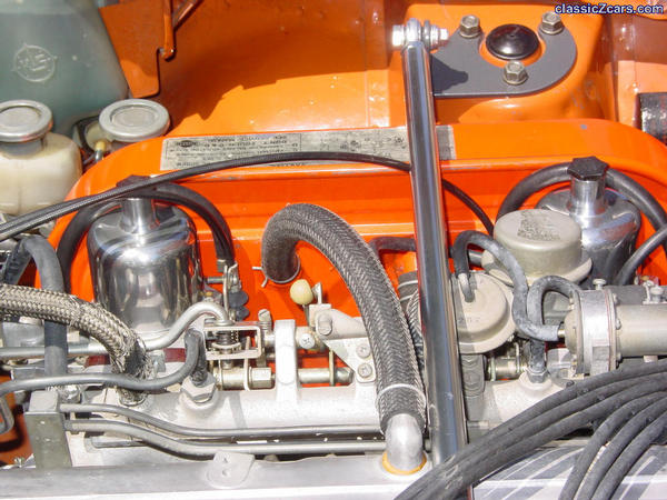

are those the dome top carbs in that pic there???
one sets like that and the other set well is huge & chunky looking.
so your saying the smaller round tops are better, i hope so there not so ugly, LOL.

Hi ,Guys
The Carbys in the pic are Brit SU,s they have the float
camber at the bottom the 240Z carbys are better in my opinion.
The 240 Carby's have the float camber to the side and the
mixture nut at the bottom. Got a spare set of SU's (240)
that need an overhaul have not gotten round to it yet.

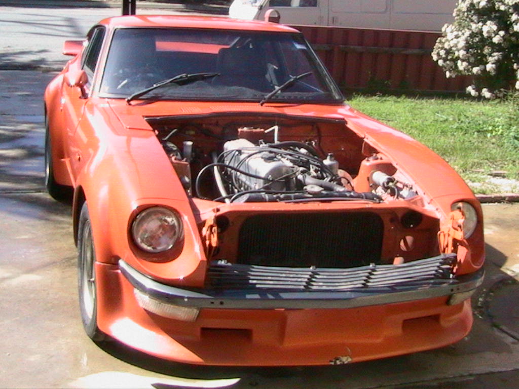

The engine in the picture is a L26 Spare. I have an L28
Turbo motor I am looking to put back in. looking for a suitable
Manifold while I learn more about Turbo setups.

Att a picture of 240Z Carbys.

my pics have come through ill try posting them up for ya's....
