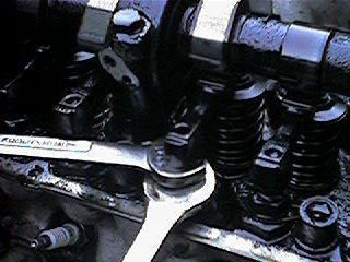

Ok, see the photo? The top wrench is a 14 mm. it's on the "Stud", witch is threaded into the head and it's height sets the pivot point for the follower.
The lower wrench (17mm) is on the "Lock" witch jams the stud in place.
To adjust, loosen the lock, whilst holding the stud still. Raise or lower the stud to set the clearance between the heel (base circle of the cam and the lash of the follower. Oh, and remove the guide spring on the follower before trying to adjust, as it gets in the way. Needle-Nose pliers does good job at this. (Be sure to put them back when your done!)
Now, here's the trick. As you tighten the lock back down, you'll inadvertently close the gap a little. Learning how to "Feel" the Feeler gauge is beyond my wordsmith skill to describe.

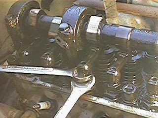

here we are the tuning is done, not a big probleme finaly, the hardest is to unlock the nuts.
I tune the valve when the engine is cold so no probleme and set 25/100 mm to the exhaust and 20/100 mm to the inlet.
