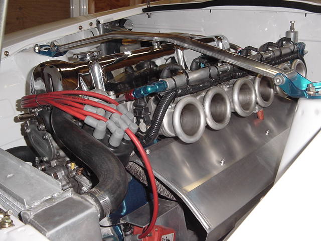

I'm open to any other suggestions, but the cheapest and easiest would be to install the heat shield first you could grab one from any wrecker but I was gonna go and get mine made up becaue the stock one is useful but has it's flaws.
This is my inspiration :).
