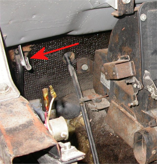

Or, I just looked through my picture files, and is the attached picture the pinch bracket that you're talking about?

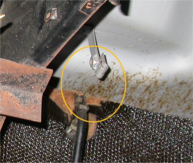

I think I'm finally getting the idea. In the attached picture, you can see that bracket that I asked about in the last picture, as it lines up with the little bracket on the top of the accerator that I now know is for the cable end. I gather that the cable goes through the pinch bracket, through the little plastic grommet on the top of the accelerator, and there's a lead ball on the end of the wire to keep it from coming back through. Thus, if you pull on the throttle, it pulls the top of the accelerator forward, which is like pushing on the pedal. If the hand throttle is not pulled, then pushing on the pedal just has the top of the bracket slide along the wire. Do I have it now? Looks like all I need is a cable...
The bracket in your photo is to grip the cable sheath. Adjust it so that you aren't IMMEDIATELY pulling on the cable, i.e. you need to take up a bit of slack, so that there won't be any conflict with the normal operation of the accelerator pedal.
