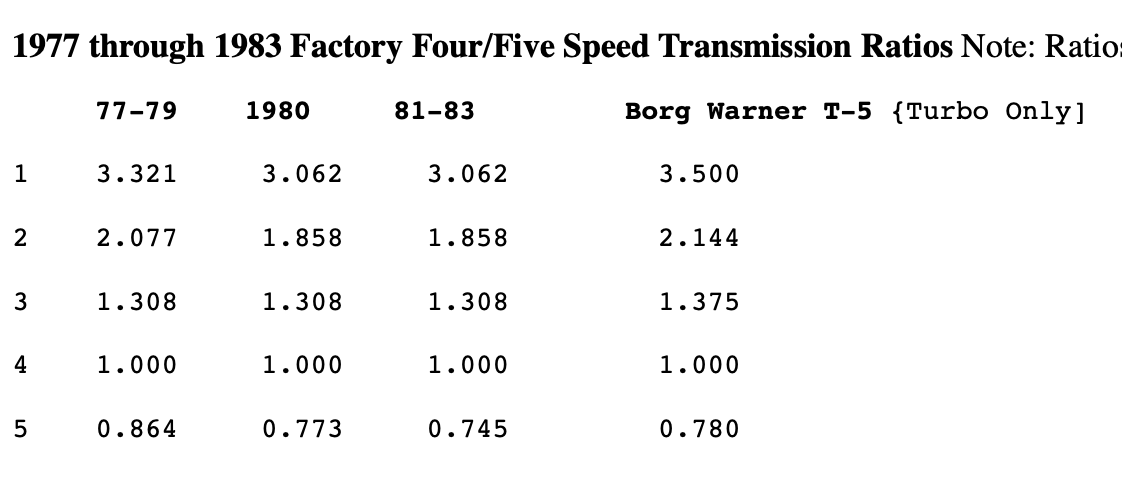

July 29, 2024Jul 29 comment_667738 Overdrive gear (final gear ratio) varied somewhat in the various years of the 5-speed... Difference shouldn't be huge, but... Link to comment https://www.classiczcars.com/forums/topic/68969-75-280z-5-speed-swap-from-81-280zx-any-catches-i-should-be-aware-of/?&page=11#findComment-667738 Share on other sites More sharing options...
July 30, 2024Jul 30 Author comment_667748 6 hours ago, cgsheen1 said: Overdrive gear (final gear ratio) varied somewhat in the various years of the 5-speed... Difference shouldn't be huge, but... According to the chart here - 1981 has .745 5th gear quite a range over the years as you pointed out, so if comparing to others, the year does matter Link to comment https://www.classiczcars.com/forums/topic/68969-75-280z-5-speed-swap-from-81-280zx-any-catches-i-should-be-aware-of/?&page=11#findComment-667748 Share on other sites More sharing options...
