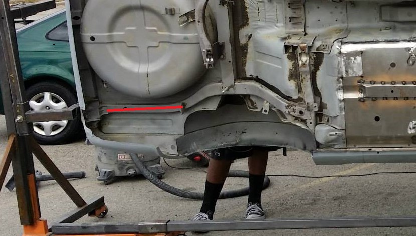

Any chance someone could measure the distance between the two muffler hanger frame mounts? My Inboard mount was broken off the frame. Of course, I forgot to reweld it prior to undercoating, and I cant recall the exact location as I did too good a job repairing the area 🙂

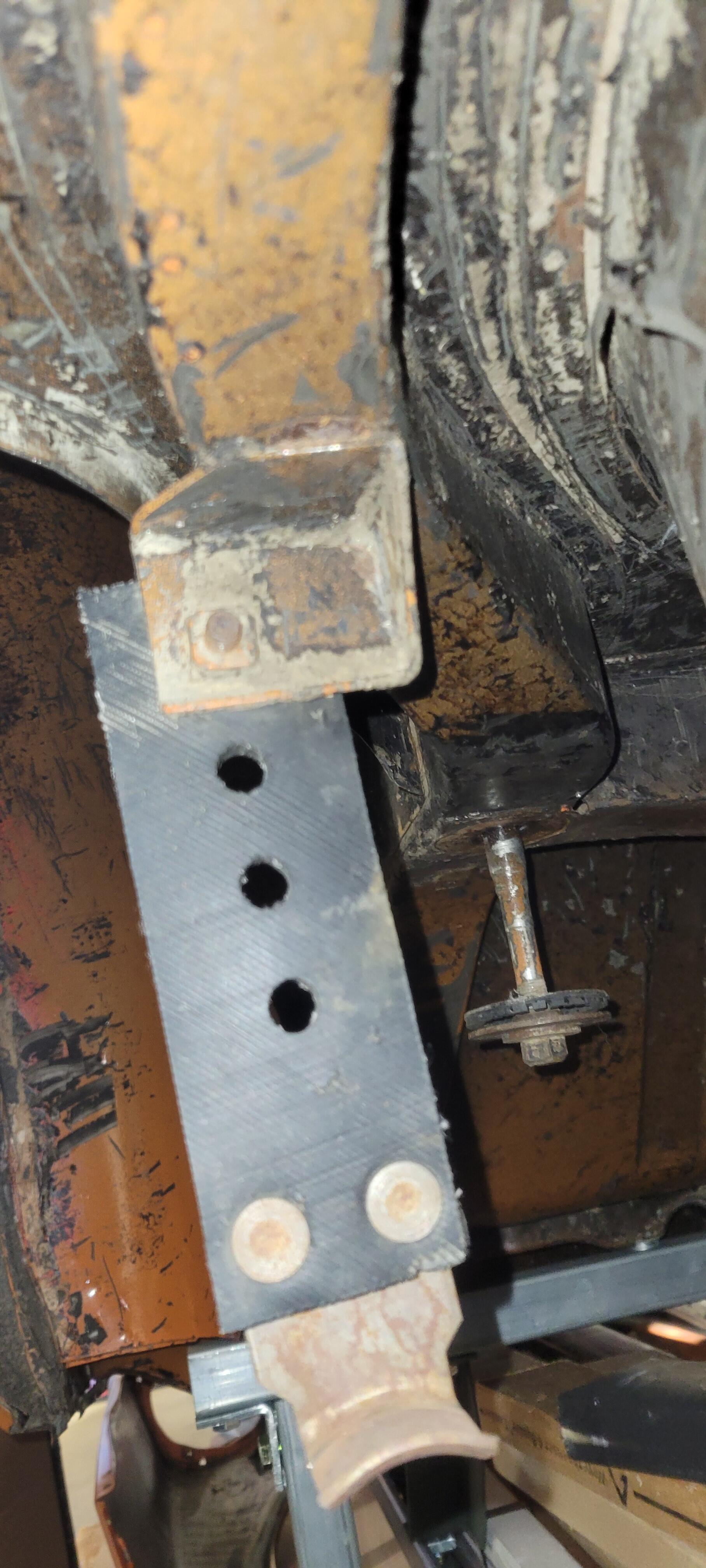

Picture attached that i got off the net with the needed measurement as a red line. Second picture of the piece I need to weld. If you have a good picture of how it is oriented that would be great. Many thanks.

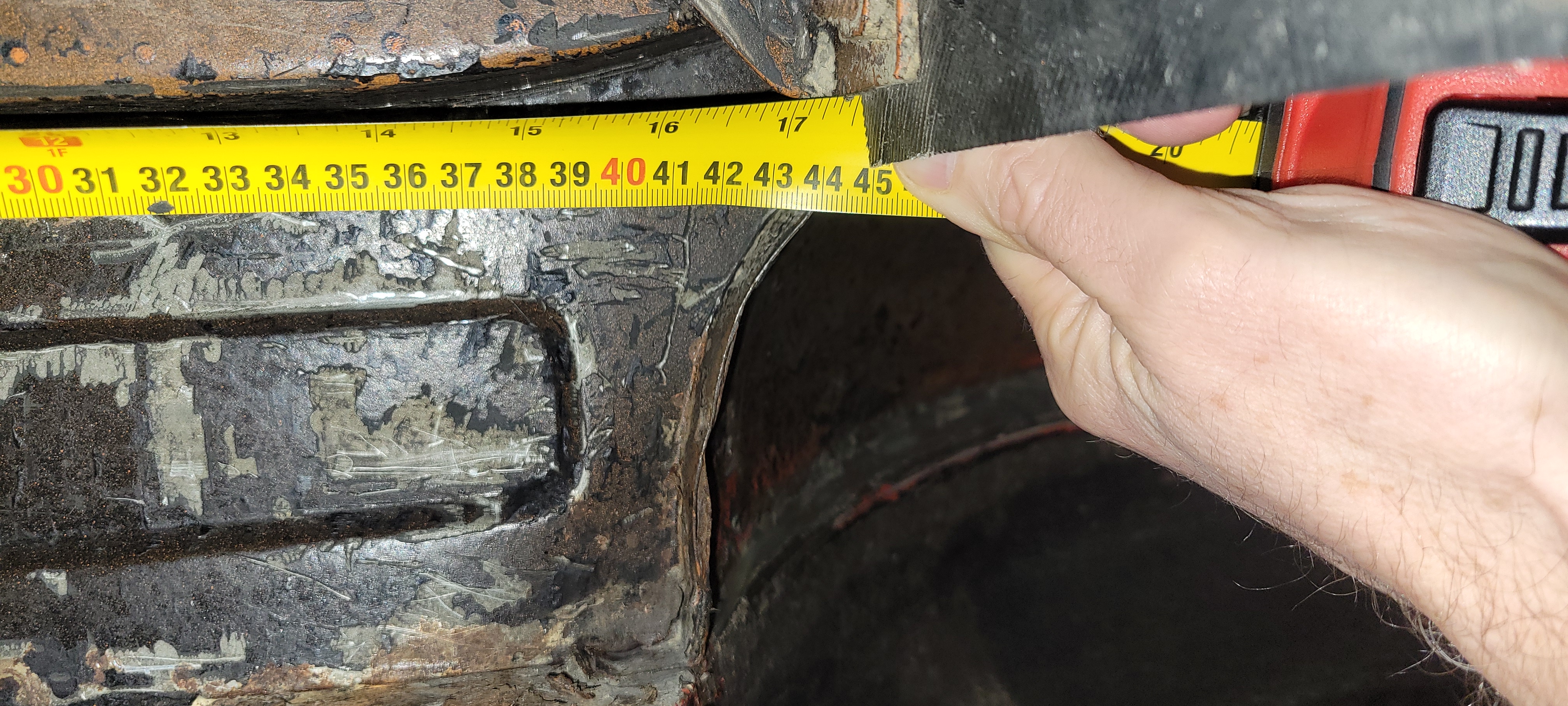

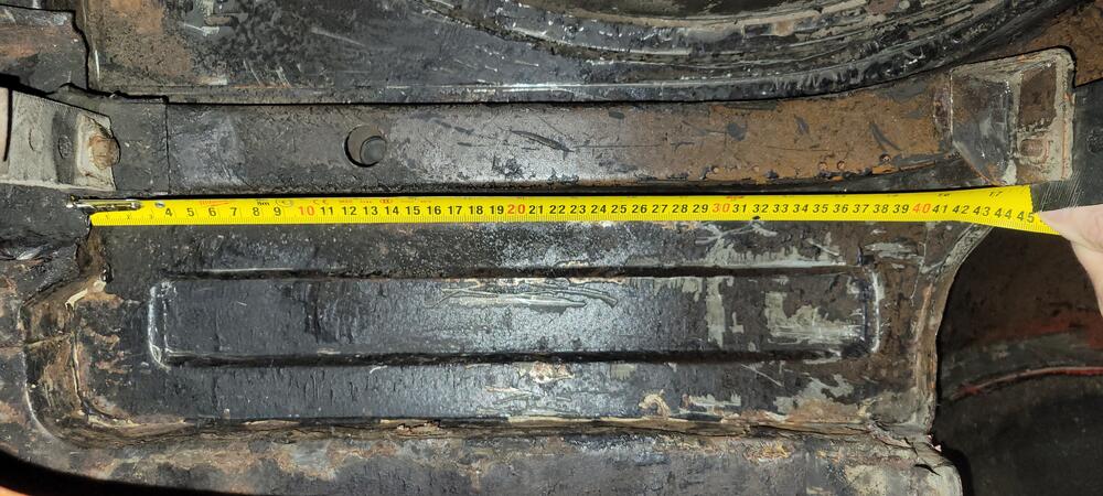

The measurement on my 7/70 is 17.5" back to back of the vertical face on the brackets. Hope this helps.
